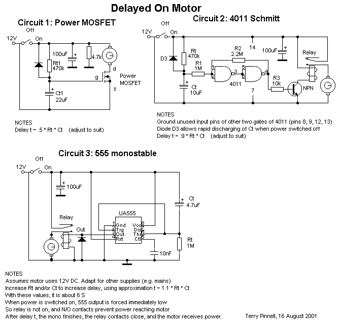

Search for 555 monostable multivibrator in Google.

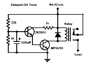

ON Delay
On Delay

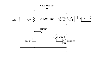

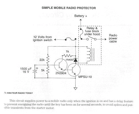

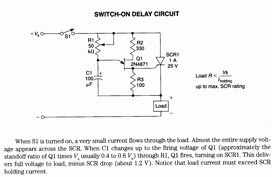

Need more?
