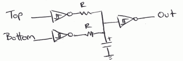

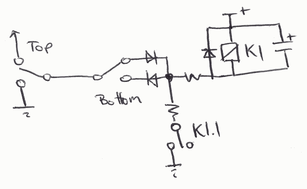

Either of the attached circuits may do the trick.
One shows the implementation when two microswitches are used. Here, if both are off for a small period, then the relay turns off; if both are on for a small period, then the relay turns off. Any other state and the relay just holds its state. The second contact of K1 (not drawn) provides the switch output.
The second shows a similar function using schmitt triggers, which could be used if the inputs are from a logic proximity switch. The output is logic level.
Both circuits will have an issue if dropping a number of ball bearings in the top results in the top switch duty cycle being > 50%.

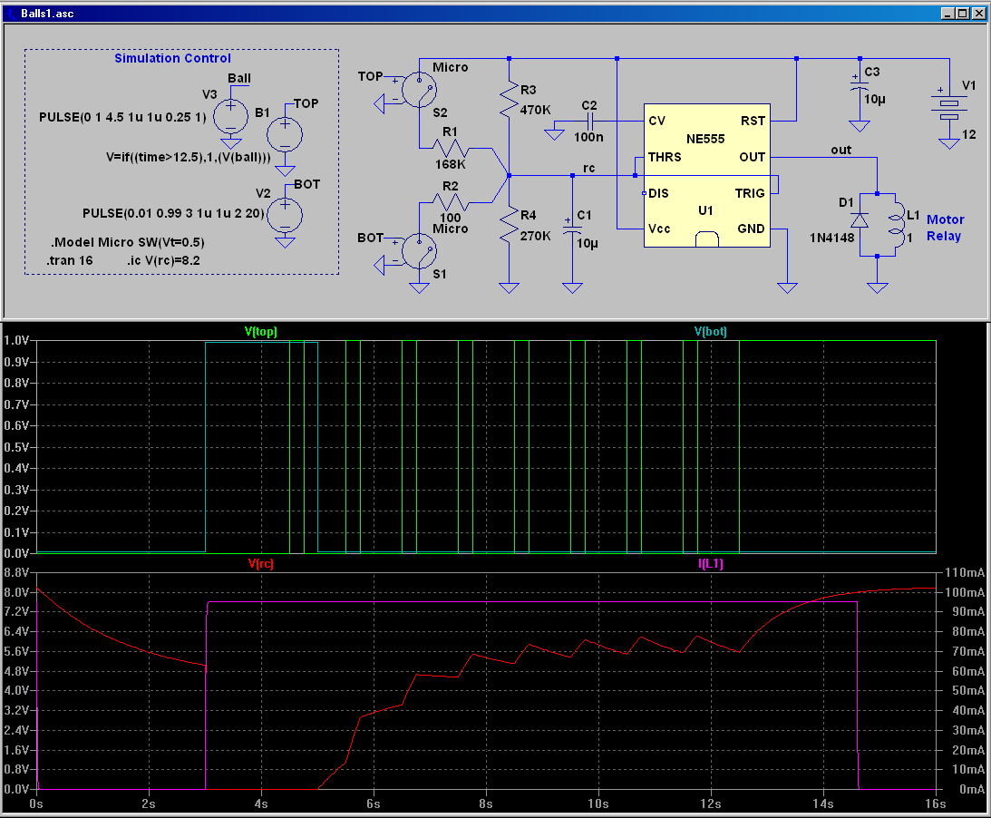

Here is my design. Look at the upper plot pane, where the simulation control signals for the two micro switches are shown. LTSpice uses a switch model that is controlled by a made-up voltage. The switch is closed when the control voltage >0.5V.
Initially, the tube has at least one ball which is holding the bottom switch in the open position, as depicted by the LightBlue trace V(bot). At three seconds, the ball is removed causing the bottom switch to close. That cause the motor to start, dropping a series of balls past the top switch as shown by the Green trace V(top). Eventually, at 12.5s, the tube fills with balls so the last ball holds the top switch closed, shutting off the motor.
I'm using a 555 as a Schmitt trigger with predictable trip points of 4V and 8V. The purpose of the network consisting of R1-4 and C1 is to discriminate between a low state (<4V), an intermediate state, and high state (>8V) of V(rc) Red trace V(rc) in the lower plot pane. When the bottom switch closes (empty stack) this immediately pulls V(rc) low, triggering the 555, causing its output pin 3 to go high, thereby pulling the motor relay. The current through the relay coil is shown by I(L1) purple trace.
To reset the 555 to turn off the motor relay, V(rc) must get above 8V, which happens only when the top micro switch is closed for more than 90% of the time. The pulses caused by the falling balls do not get V(rc) high enough; only when a ball keeps the top switch closed does V(rc) rise high enough to reset the 555. The motor relay should be 12Vdc with a coil resistance of >80Ω.
Note that it takes a while after the top switch comes on steady for the circuit to shut off the motor. You should mount the top switch a little down the tube because an extra ball or two may drop in after the top switch comes on steady.

Mike, only one problem.. there won't be a ball bearing in the tube to start with. The lower switch has to be up at least 10 ball bearings so that the bearing feeding machine doesn't run dry before the feeder motor kicks on to refill the tube and hand feeding them isn't practical.
thanks for your help. What you gave me is very close to what I need.
...Mike, only one problem.. there won't be a ball bearing in the tube to start with. The lower switch has to be up at least 10 ball bearings so that the bearing feeding machine doesn't run dry before the feeder motor kicks on to refill the tube and hand feeding them isn't practical.
No. I just happened to depict the initial condition such that there where balls in the stack. The design doesn't care. It works just fine if the stack is empty when the power is turned on. In that case, the bottom switch is initially closed, that triggers the 555, and the motor starts running. The first ball down the stack creates a pulse at the top switch (which is ignored) and then falls to the bottom and opens the bottom switch. The motor keeps feeding balls just as before until the top switch stays closed.
I though about a version with only one switch. In that case, I would locate the switch at the bottom, and use a timer to run the motor for x seconds after the first ball trips the switch. I would still use a 555 to drive a relay...
