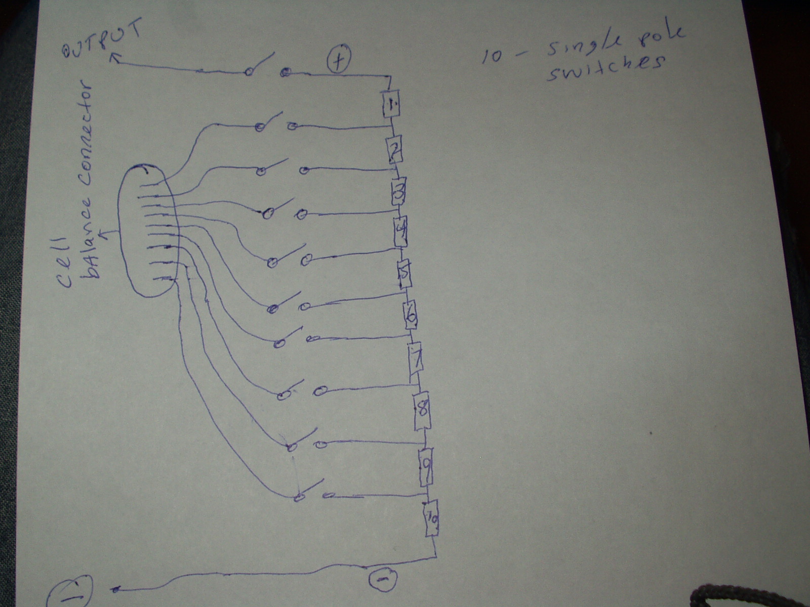

Can you give us a diagram of how the toggle switches are now connected to the batteries?

k7elp60, I have attached a drawing of the switches.

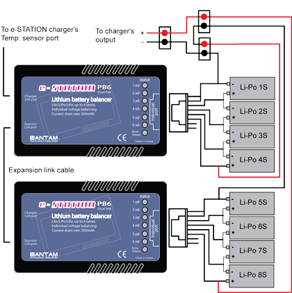

Ok, this is how they are balance charged. The port labeled to estation charger temp sensor. This will monitor each cell voltage on the charger and displayed
on the chargers screen.

I am a little confused as you say there are 10 batteries of 3.6 volts each, yet in the posting showing the equilizer there are 4 batteries in series of 3.6 or a total of 14.4. Each battery pack is in parallel with the charging voltage. So the charging voltage is around 14.4 volts then, or do I have it all wrong?

I see where your confused, sorry for that. The picture was taken from their
website. One balancer can balance anywhere from 2-6 cells. My hand
written drawing shows exactly how my battery pack is wired. 10 cells
of 3.6volts each for a total of 36volts.

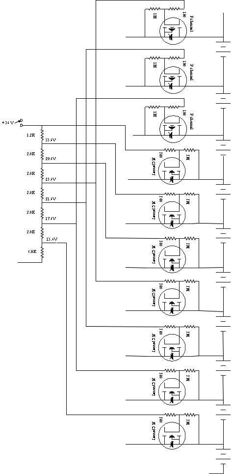

I am not an expert on Power Mosfets, but I have been able to turn them on if the gate voltage is about 10 volts higher than the source voltage and a small resistor is put in series with the gate terminal to overcome the gate to source capacitance. Most mosfets also have a maximum gate to source voltage. The ones I looked at this was 20 volts.
Here is a possible solution. I used P channel in the top three switches because if N channel were used then a voltage pump would be required to boost the gate drive voltage. Individual mosfet drivers could be used for N channel mosfets for the top three as another solution.
See attached diagram

The 180 ohm resistor from the gate to the voltage source helps compensate for the gate to source capacitance. The 1M resistor from the gate to source is there for two purposes. 1 to prevent false triggering by noise and to help with the turn off the mosfet when the gate voltage is removed.
I chose P channel mosfets so I didn't have to use individual drivers because the gate has to be about 10V higher than the source voltage. By using P channel mosfets and connecting the source to the supply and the drain to the load it overcomes that problem, even thou it is a postive voltage on the gate is at least 10V more negative than the source.
If you use N channel mosfets for the top 3 switches you have two approaches. 1. use individual drivers or 2. use a voltage pump to boost the gate voltage to about 46V.
