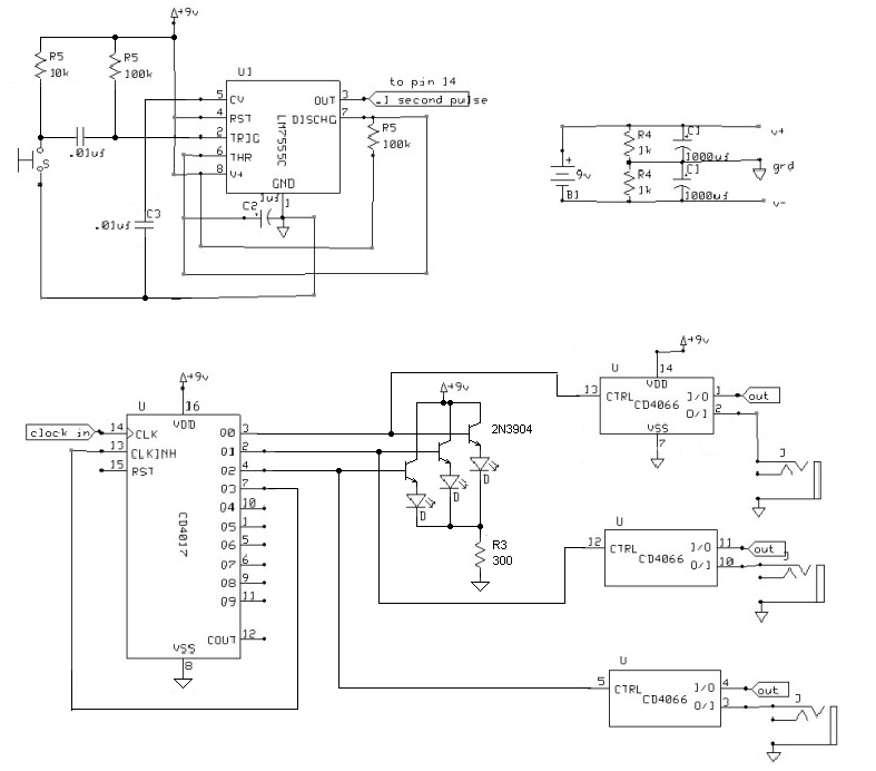

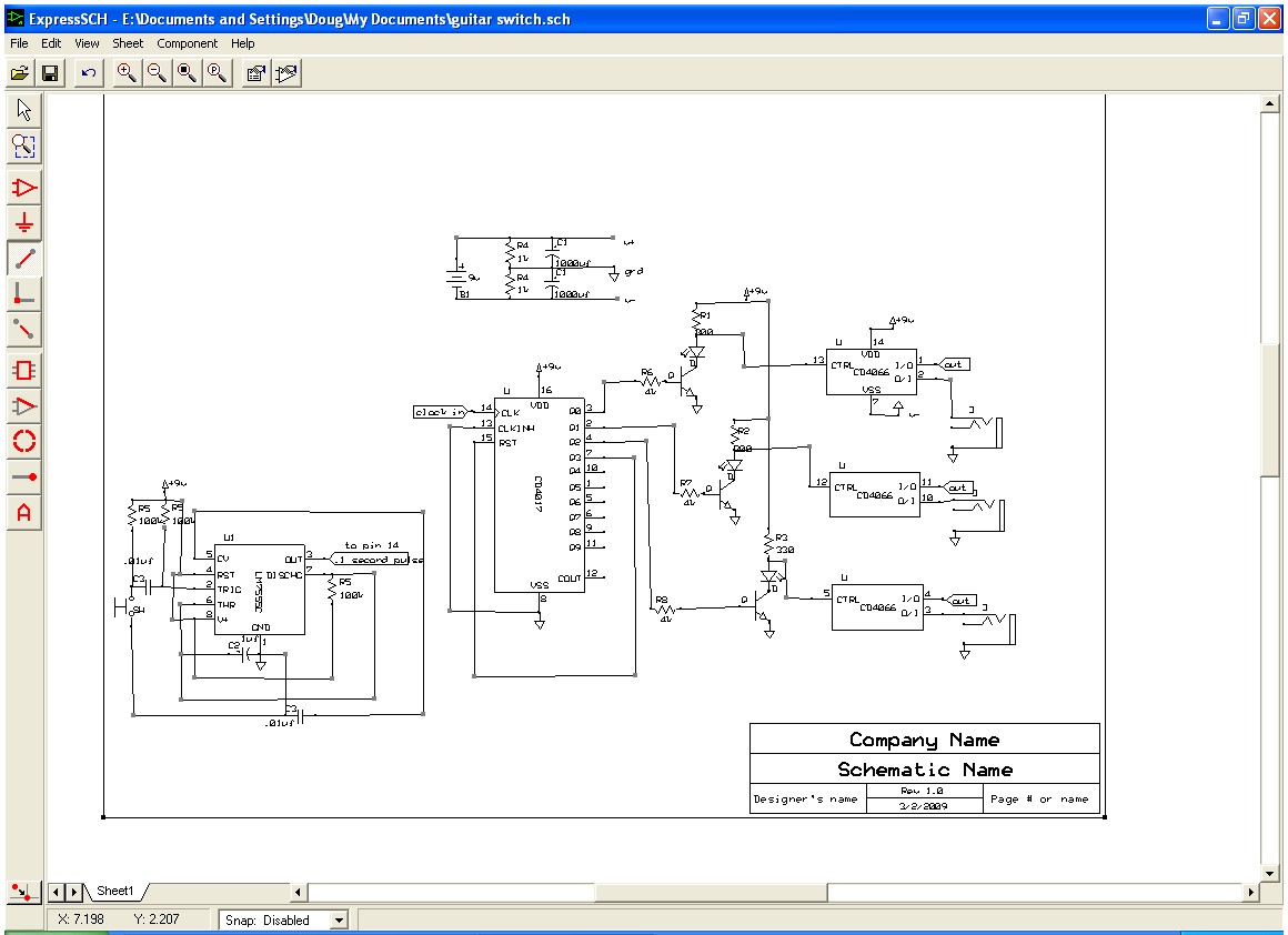

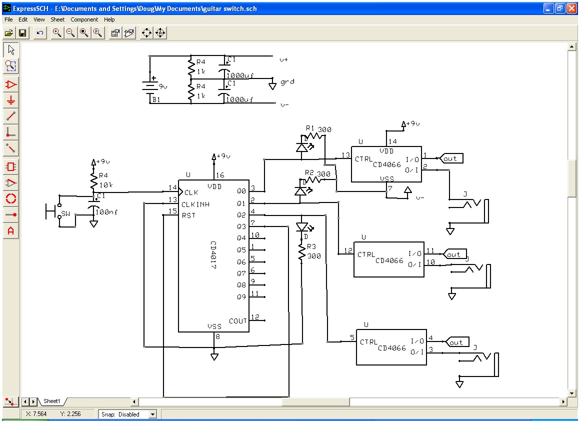

here is the start of
a circuit using the 4017 and the 4066
you should maybe include 2n2222 transistors to drive the LEDs and the 4066 outputs

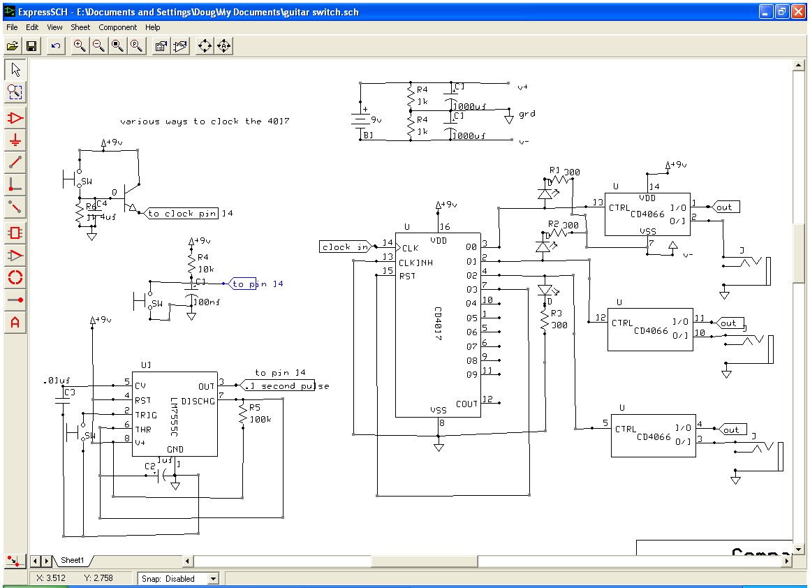

Both of the clock debounce schemes recommended above ignore the clock maximum rise and fall time spec (see the datasheet). After the RC network, you will need a Schmitt trigger (CD40106) or a 555 configured as a Schmitt trigger. You could also use a 555 as a oneshot.
this should work
the 7555 is perhaps the best of the three?
The 7555 is the only one that meets the rise and fall time specs of the 4017, but it needs a pullup resistor from pin 2 to +9V, and the input pulse has to be shorter than the output pulse. Either make the output pulse longer, or add a differentiator between the switch and pin 2, as shown below.
CD4017 will not reliably provide enough output current to light an LED and still have a good enough logic high level to switch a CD4066. Add an emitter follower for each LED, as shown.

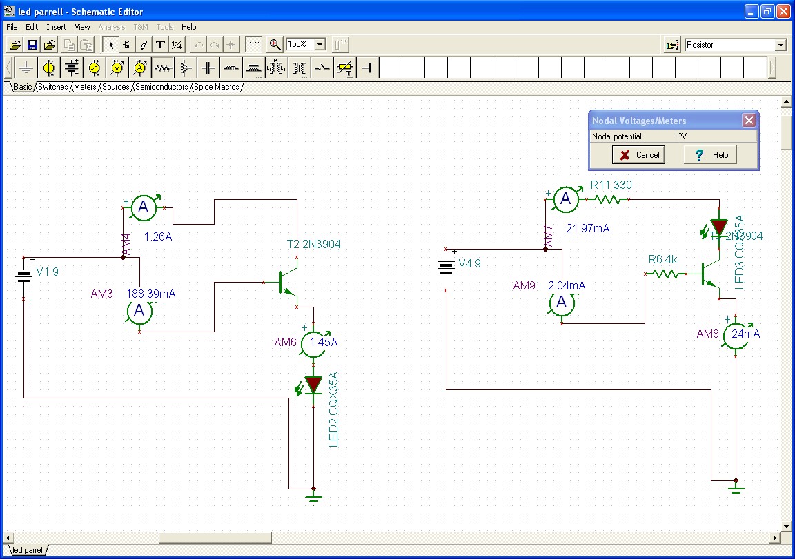

emitter follower circuit of Roff
your transistors need base resistors (the 4017 and/or the transistors will go poof!
the LEDs won't run to good with more than 25-30ma
see screen shot of TINA simulation
