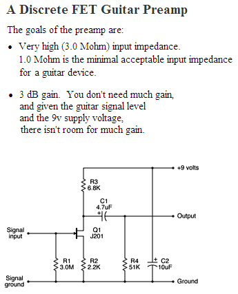

Most guitar pickup circuits on the web say that the output of the pickup is in Volts, not millivolts and a gain of less than only 3 is needed.
I guess they come with a preamplifier nowadays. Mine were just the pickups without any amplification.
Here is a typical preamp. Its gain is only 3dB which is only 1.4 times the voltage:
