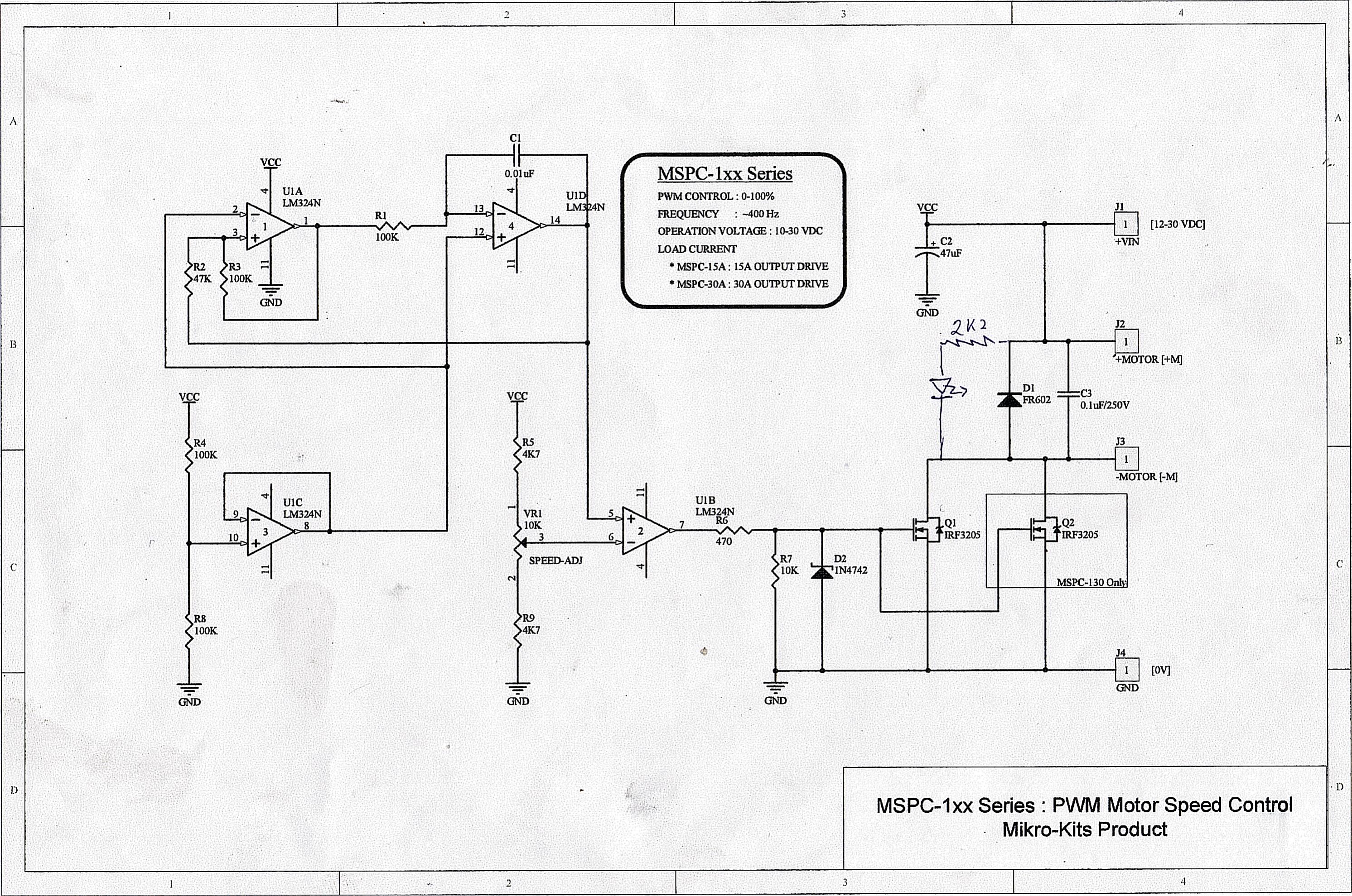

Hello All,
I need your help, I have one 12 volt 10 amp gear motor and I have two speed controllers. One for foward, one for reverse. I had planed on using a feedback speed controller, but its a lot cheaper and less head ache to use two seperate speed controllers. I need to use two because the motor is pulling and pushing a relativly heavy weight and I am trying to get similar speeds in forward and in reverse. I just need a little help on how to wire it safely. Both of speed contollers are 12 v 15 amps.
If this is a dc motor, you dont need two speedos to control direction...
Use a Double pole double throw switch to swap the motor conections....

Chippie is right,you don't need 2 speed controlers,(I presume you are using PWMs) all you need to do is make sure the PWM is capable of drawing 15 amps continuous,(many PWMs don't survive.& the mosfet fails) I allways "over spec" them by either fitting a higher rated mosfet,or fitting 2 similar ones,& an extra heat-sink & fan.Also make sure the switch contacts can cope with the current (they could burn out) I think it's best to go for an upgrade straight away,to avoid future problems.This is what I would suggest;Use a 30amp PWM,& two 5 pin,CO 16amp Relays,controlled by a 3 position switch.suitably rated wires for the main supply & lighter gauge for the remote control.
It's a simple circuit, good luck.Terry:

I need the motor to travel at a certain speed going forward and a different speed going backwards.
Can you post up details of your speed controllers so we can see how the speed is adjusted ?
It may be that we can use another switch to switch between two pots that are set to give differing speeds back and forth...
Hi,Boncuk, Search for Primo PDF, & DOWNLOAD THE FREE TRIAL version,I was so impressed with it,I subscribed to the full version.The system installs as a printer,in your printers & faxes folder,and when you press print,it gives you option to select it;1st create printable files (keep them in a seperate folder to find easy) press print,& primo will give you the choice which files to "merge together)you should not have any problems uploading the PDF,If you have trouble uploading BIG files,try "Yousendit Express" o.k. the IC for the PWM is LM324N,it's a 14 pin chip & very cheap to buy,
allways install it on a 14 pin socket.the Mosfets are of your choice,just go for a high power N Channel version. the PDF I've posted is one of my early attempts,now I've seen it again,I will create a better one: good luck;
Just a quick reply,while I get my head round this one,as Chippie suggests,it's possible to acheive this with 1 speed controller,as you know the current draw from a PWM is controlled by the "pot",it is possible to create a circuit with 2 settings (either adjustable or pre-set) it would help if you could say what you intend to use it for,e.g is the set up static ? or does it need to travel around.this is important to determine how you will control it via remote.

bi-directional speed control
I don't know how you are progressing with your project,so I thought you might like to look at different PWMs,including Bi- directional speed controling,so here is a PDF.
