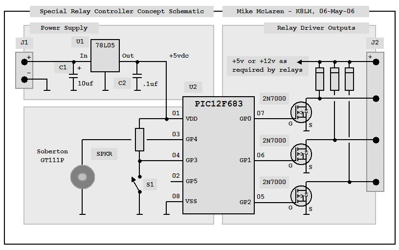

Ok guys, in the hope that this might help push you newcomers in the right direction, here's a quick-n-dirty 8-pin 12F683 solution/concept... Note: code is "untested", simply thrown together while waking up with my java this morning...
A switch press provides a 40-msec 500-Hz beep for audible feedback and cycles through relay 1, relay 2, relay 3, and relays off...
The code is much more elaborate than need be, using 1.0-msec interrupts and switch code from a recent project that was really designed to process up to 8 switches in parallel in the ISR (interrupt service routine) including the use of a 5-bit vertical counter to debounce switches independantly... Once you look past the ISR code you'll find simple initialization code and the main program switch/relay logic code...
Have fun... Regards, Mike

eblc1388 said:
Your objective is to learn PIC programming and build the device to control the relays. Don't expect this to happen within short period of time as there will be a steep learning curve, weeks perhaps. There are more informations in the sticky of this forum and please go and have a look.
Actually, based on the OP, I believe his objective is to control the relays. the PIC is simply one means to an end. I think it is hard to justify all that goes into learning PICs for a single project (especially this one). However, if other projects are envisioned, then all that trouble to learn will pay off.
to those who suggest bigger PICs, lets keep in mind that this project needs 1 input pin, 3 output pins and all of a couple hundred instructions. I'd buy (or sample from microchip) the cheapest one I could find. Basically, I don't think there is a PIC that won't satisfy the requirements.
