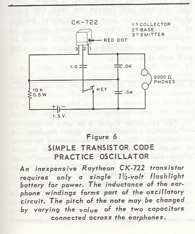

Neither my 1963 ARRL Handbook, nor my 1962 Radio Handbook have a tube CPO. By 1962, they have this circuit:
In my 1954 ARRL Handbook, there's a 6SN7 audio oscillator, but it's high impedance (4700 ohm) and isn't keyed. It uses 150 volts on the plates.
Good old leaky germanium transistors. No need for a bias resistor!
