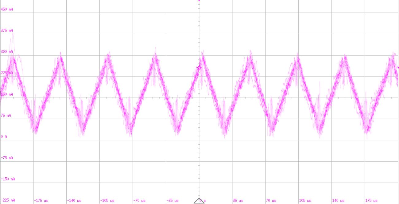

I can see you really have great knowledge regarding boost converters!
Anyway here's my current waveform at L2 using a current probe. Looks rather noisy right. Image at Capture 1

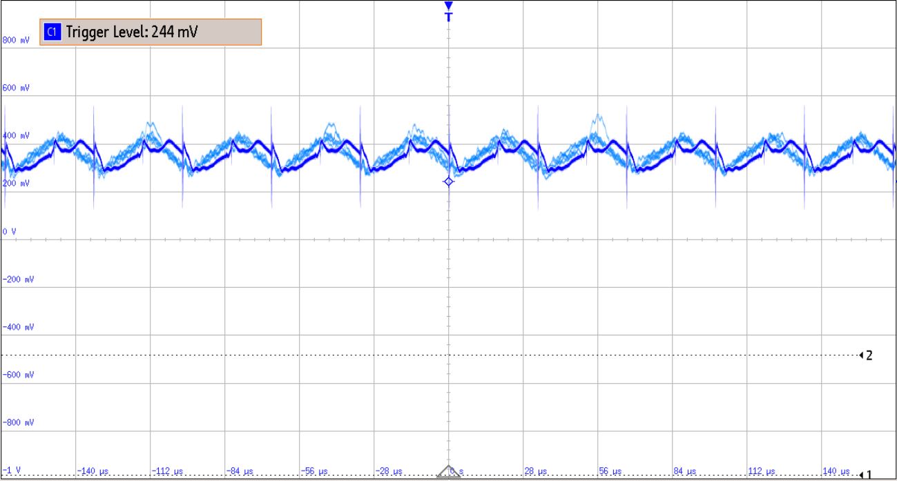

Using a current sensor circuit(LM741) via a 0.1ohms resistor is even noisier (Already With a capacitor at the output of the op-amp to ground) hahahaha. Image at Capture 2. Dark Blue is using current sensor circuit, Light blue is via Current Probe.
You can observe that there is a slight phase shift between the two waveforms.

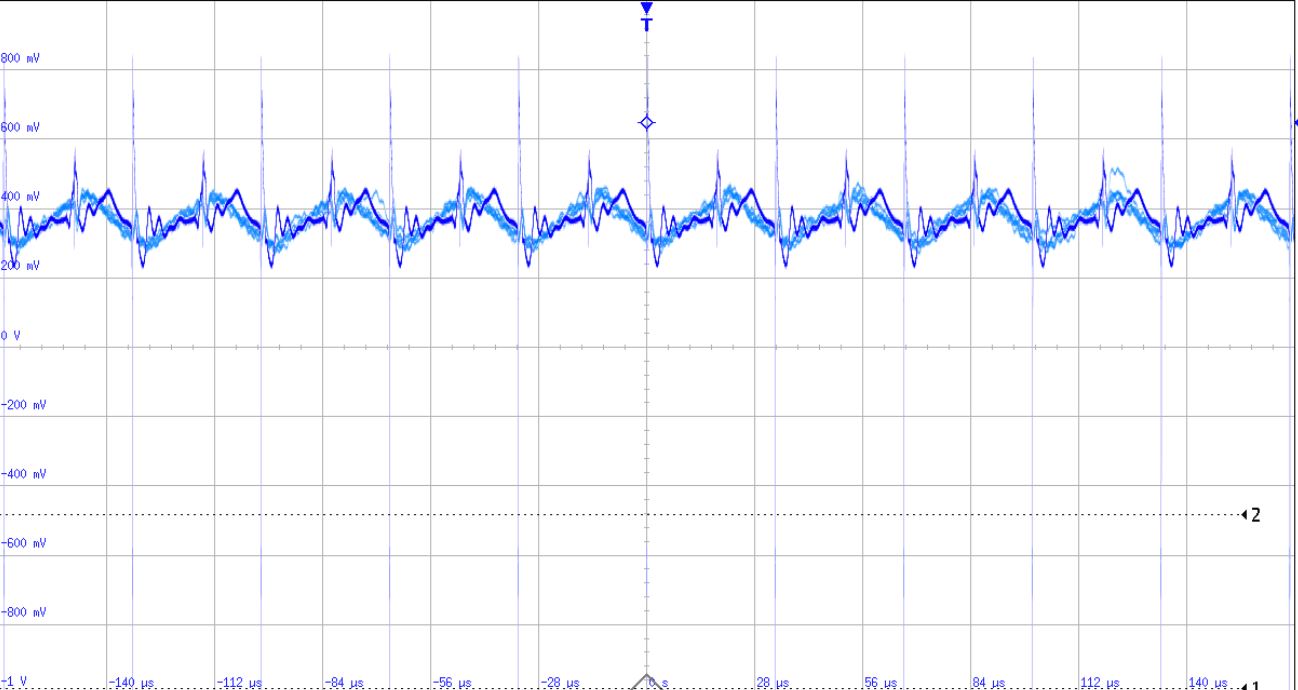

Without a capacitor. Image at Capture 3
