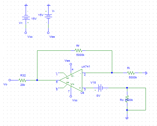

I am constructing an IC tester for op-amp now, which require to test most of the fundamental parameter of op-amp and need to make sure that, if the op-amp pass my test, then it should be working fine.
So I construct a simple circuit to test for it's parameter.
Currently I can only able to test Input offset voltage, Input offset current, Input Bias current.
So how to test the other parameter like input impedance, output impedance, CMRR, slew rate, voltage swing or any other?
This is my circuit that can test the offset current/voltage, bias current by varying the Rf, Ri, Rc value.
So what can i add in to test the other parameters and how?

You saved your schematic as a fuzzy JPG file type so we cannot see its details.
Instead, save it and post it as a very clear GIF or PNG file type.
And please turn off those awful dots all over the place.

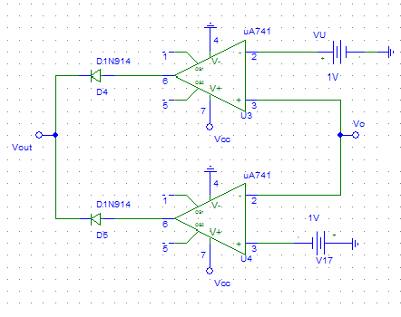

Sorry for the picture, i reupload my test circuit again :)
Basically is using a window comparator to test the output of my test circuit.
The test circuit Rf, Ri, Rc will be varying by switch of parallel resistor to lower down its value.
I test for this IC because of my campus first year electronics 3 study about this IC and my lecturer request me to test this IC (May be he wan to use this).
For the pdf file, i had read and can't really get the point from there.
Because I can't use any hand testing but fully control by micro-controller.
So basically I just can test the IC by some maximum voltage by calculation and feed into micro-controller.
But now i got not much ideas on how to other parameters like impedance and so on can be tested through the output voltage site :)
