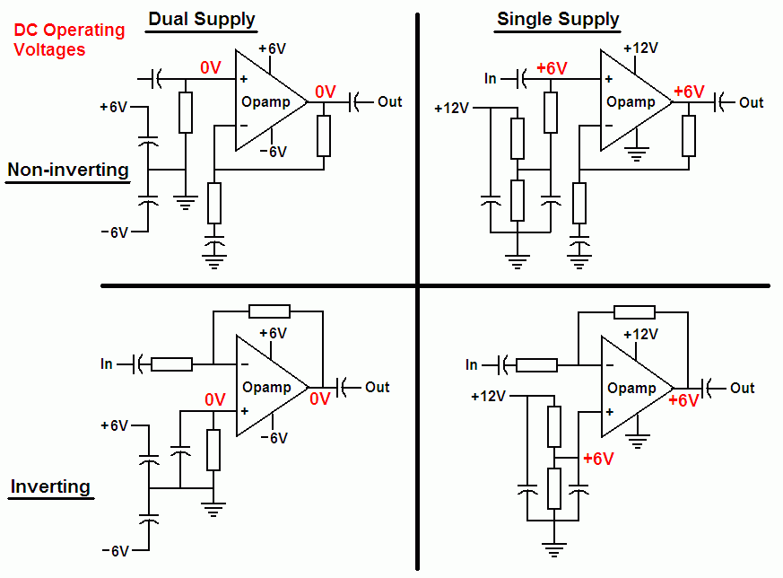

Opamps don't need a dual polarity supply.
If you bias their inputs properly at half the supply voltage then a single polarity supply is fine for all opamps.
Look at their datasheets to see the range of supply voltage. Most opamps work fine from a 7V to a 36V total supply voltage.
