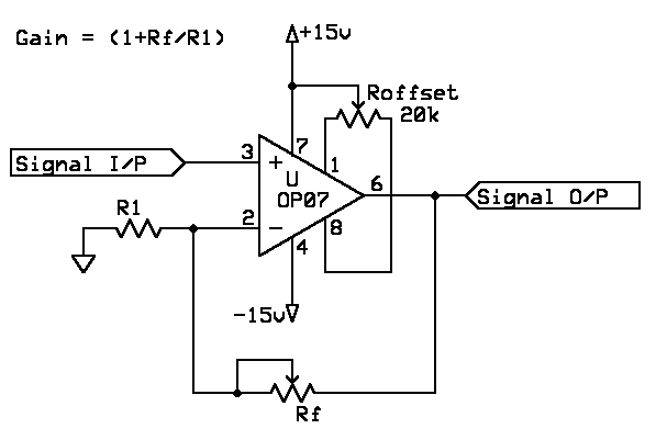

You can use low noise precision op-amp like OP07. See sample non-inverting DC amplifier with offset adjustment below.

Thanx for the op-amp info. Will try it to see whether it works for the temperature sensor. But is there another op-amp with 5V Vs instead of 15V? Btw, how does anyone look for the correct op-amp for their circuit? Is there a page that can search for specific op-amps based on the characteristic input from us?( Other than searching thru search engines and manufacturer's website)

Regarding 5V supply, you can use OP07 right from +-3V to +-18V.
So just change the supply voltage to +-5V in the above given circuit. It will work.

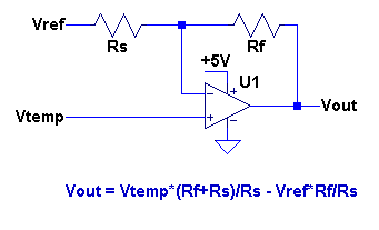

I'm guessing that you have an 8 bit A/D with a 5 volt reference. It sounds like you need to amplify the signal and subtract an offset from it. What is the range of the voltage you need to amplify, i.e., what is the sensor voltage at the low temperature, and what is the sensor voltage at the high temperature?

Yeah your're right...Im using 8 bit ADC with 5 volt voltage reference. According to the temp. sensor data sheet, the output voltage at 36Celcius is 360mV(10mV/C). Therefore I thought of first dropping the voltage before the opamp and then amplify it with 36C as the 0V(or any other reference point) and 38 or 39C as the max. Btw, I dont exactly understand the offset voltage. Is it the voltage for calibration when comparing to melting/freezing point?

I'm posting a "hint" schematic below. What are you doing this for? Is it for a class?

Hrmm..i guess that a simple differentor circuit right? Doing this for a simple project of mine. Well, thanx for the tips ron.
