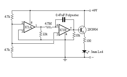

What I'm trying to do is to create a triangle wave using op-amps so that I can make a LED fade on then fade off. At the moment I'm using the circuit that I attached.
The first problem I'm having is getting the attached circuit to even work. Using the values that are shown in the schematic all that happens is the LED comes on and then stays on. I tested the op-amp outputs for any kind of wave form and there is nothing at either output.
I've tried adjusting the values of the components and the best I can get the circuit to do is to make the LED fade on, put after that it just gets stuck on and doesn't fade back off. To do this I changed out the resistor that goes from pin 7 to ground from a 4.7k Ohm to a 1k Ohm.
I understand how to an op-amp can be used to create a square wave but I don't totally understand how two can be used to create a triangle wave. So most of the component adjusting I've been doing is just randomly swapping out parts.
Oh yea I'm using the LM358.
Anyways any help would be greatly appreciated.

hi,:)
You will not get a good dimming control of an LED using this method.
Commonly used are PWM [pulse width modulation] circuits.
You could use an OPA to generate a square wave, where the on/off time drive to the LED can be varied.
The 555 timer ic makes a simple PWM osc.
You create a triangle from a square wave by sending the sq wave into an integrator, which can be made from an op-amp.
I agree a sq wave with varied ON time is a better way to change brightness.

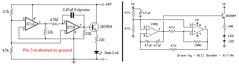

Your circuit does not work because pin 3 of the opamp is shorted to ground instead of having positive feedback.
Also, your timing resistor is much too high at 4.7M, it should be 47k then the timing capacitor value should be much higher. The circuit I show uses two polarized capacitors back-to-back so that they pass AC.
The circuit works best with a single red LED. Two red LEDs in series will be off most of the time and fade on for a very short time.

Thank you all for the fast responses. I have a much better understanding of how this works now. I got it working using the schematic that audioguru posted.
Incase you wanted to see what it looks like here's a youtube link to a video of it. I'm planning on etching a board for it soon, but here's a quick mock-up.
