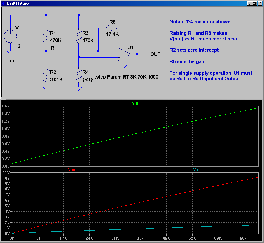

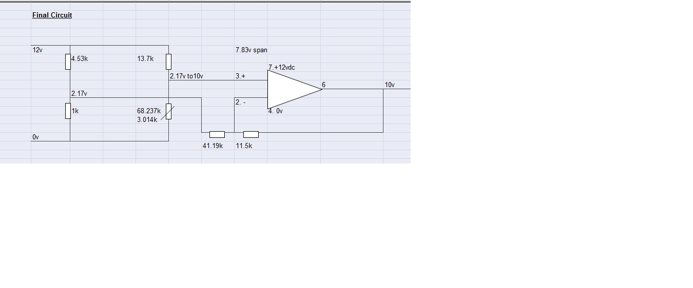

Need help, trying to scale voltage from thermistor using opamp.
from temp range = -20 to +60degc
Thermistor = 3.014k to 68.237k
voltage divider = 2.17v to 10v
Voltage = 0 to 10vdc
Have been using simulator Circuit Simulator Applet (import op1.txt)
opamp does as it should unless i connect voltage dividers then goes wrong.
Help with circuit please.

Here is my suggestion. Read the notes in the schematic.

From previous experience, I know that the Voltage across the thermistor is more linear with resistance-change when the thermistor is fed with a constant current source. A constant-current source is approximated by a voltage source (12V) in series with a big resistor. However, the downside is that the ΔV across the thermistor decreases, but we can make up for that by raising the gain in the opamp.
I have done this so many times, that I can just about estimate the required gain in my head, which gives me a starting value for R5 . Note that the zero output requires that the bridge is balanced, which occurs when R1 = R3, and R2 = RT. With a running sim, I can just iterate on the values of R2 and R5 until the line hits zero and 10V respectively.

You got it. I could have said it better this way: Set up the four-arm bridge so it is initially balanced when R4 = ~3K.
Note that the gain of the opamp is approx. [1+R5/R2] (ignoring R1, which you can do because R1>>R2).

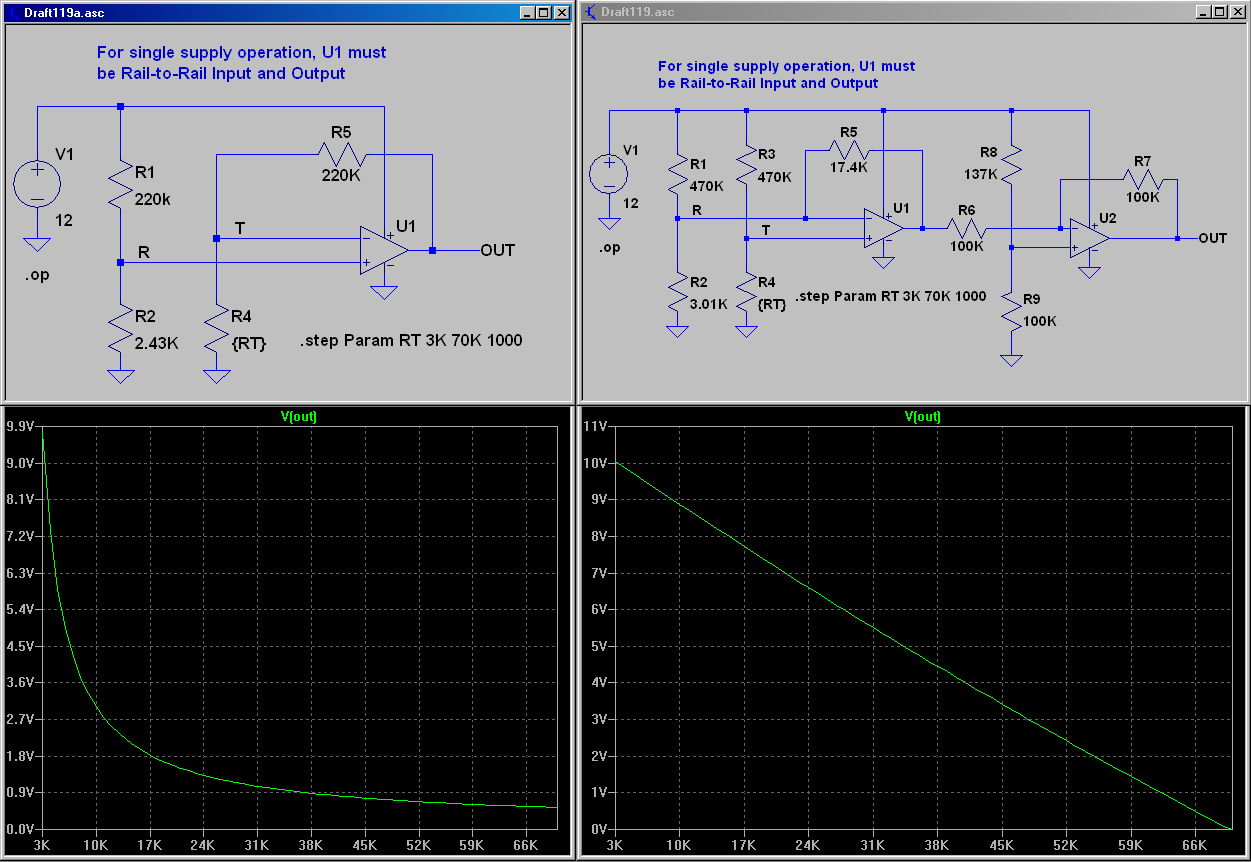

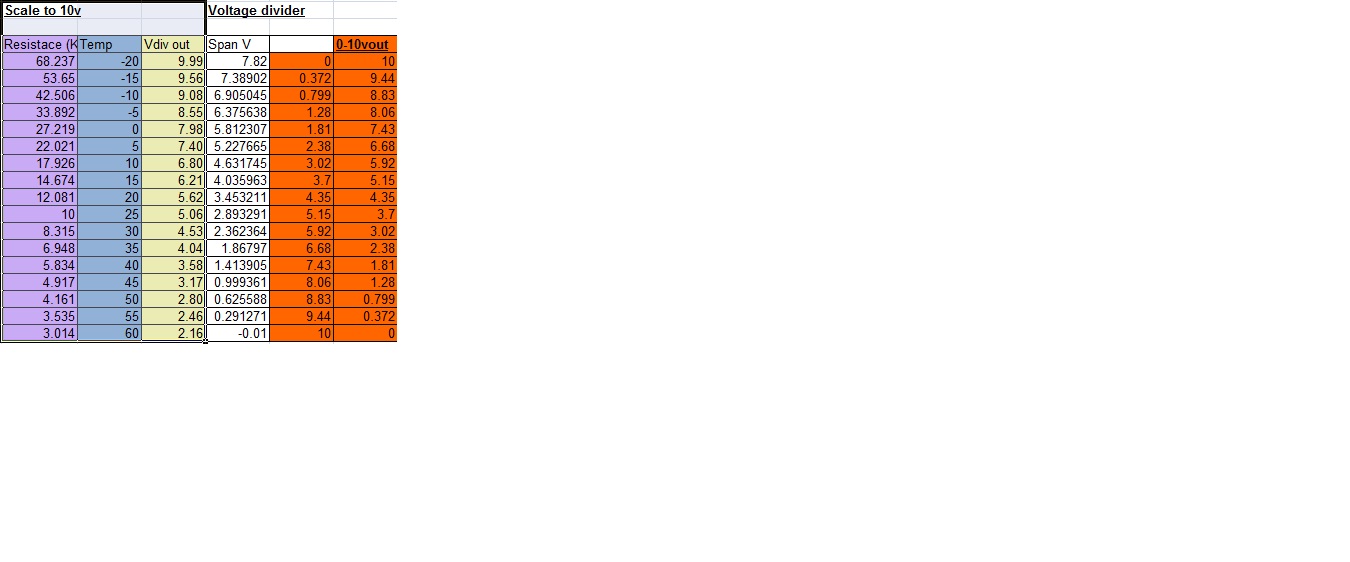

swing the other way, so to speak. As it is the higher the voltage the lower the temp. I wish to invert this to match voltage to temp. Also there is more voltage span at the lower temp so i wish to turn this around also. Please see attachment.
I dont know wether its possible to have an even voltage span for each degree of temp?

Not with a common thermistor. Try a PT100 or PT1000 instead.
This comes close: the first way is how not to do it: the second comes closer.
