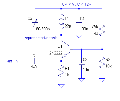

I am trying to amplify shortwave signals between 2 and 4MHz. I would prefer to put the amplifier between the antenna and the tank. My antenna is a 6 foot dipole tv antenna, but I am familiar with winding transformers for impedance matching,so imput Z can be variable. The output will be attatched to a germanium diode detctor circuit at first, then later to a transistor detector set-up. Again, I can compensate for Z on the output. I would like the gain to be sufficient to drive the diode, but if I have to, I can forward bias the diode a bit to get it demodulating. I appreciate any help I can get with figuring this out.

The circuit below should give you a place to start.

Thank you Ron, I'll build this thing tonight & post my results. This schematic is completely different than what one usually sees in homebrew radio articles. I guess I better start digging through my parts bins!

After alot of swearing and muttering under my breath, I managed to scrape the circuit together. I get a light hum, which ain't bad to start.There is also a nice lightning storm here right now, or I would run a longwire antenna over the balcony of my 3rd-floor apartment. I guess tomorrow I can do the ol' "tie a rock to a wire and chuck it as far as you can" trick.I will also play with the layout some more.My determination and lunacy might just make up for my lack of education in electronics.Thanks to everyone who's pitched in their 2 cents,it helps.My coffee don't work anymore,goodnight.

What did you use for a detector, and how did you connect it? A schematic sure would help.
demodulator used
I just added a .01mF at the positive end of the 75k resistor, then attatched a germanium 1N34A to it. My earphone is connected to the diode and ground,like a simple crystal radio.Sorry I can't yet post a schematic, I'm working from webtv.I guess I could just as easily attatch a transistor demodulator, the output impedance would go well with the hi-z earphone. Any ideas?
You connected your AM detector to the power supply of Ron's common-base amplifier circuit. Its output is at its collector, where you should connect your cap and diode. :roll: :wink:
When I recommended using a ferrite rod antenna from an AM radio, I did not mean to use a ferrite core from an IF transformer. :roll:
By golly,it works!
Thank you for pointing that out AudioGuru. Now I get stations, even though they are very very faint.But, I got what I asked for, and I appreciate everyone's help.I hooked up 12volts and it helped, nothin' blew up. Now I have a question, why is the bandwidth of this circuit from 2 to 4MHz? What adjustments to this circuit would change it's operating freqency? I have a basic understanding of transistors, which means I don't really know squat. Also, does anyone know the output impedance of this circuit, and how do you calculate the impedance without rocket-science math? I will now attempt to build an audio amp to lift some of these signals up out of the noise,plus tinker with the layout a little more,and maybe shield the coil.Thanks again!

Ron's common base amp works best with a 12V supply. It will be about the same with a 9V supply if you change its R3 to about 56k.
It will have more gain if you reduce the value of R1. 100 ohms will have a lot more gain but the input impedance will be lower.
The bandwidth is determined by L1 and C2. Reduce their values to increase the tuned frequency.

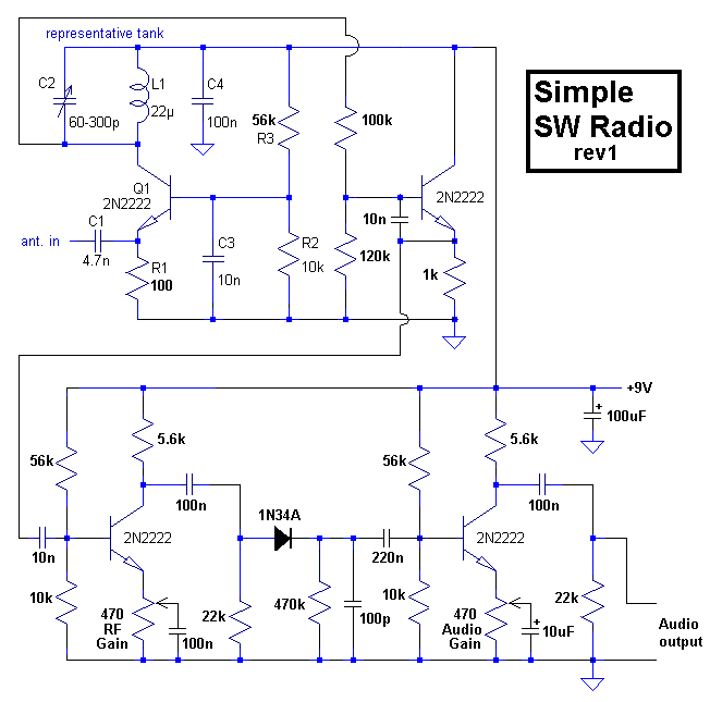

The circuit's output impedance is the collector of the transistor in parallel with the tuned circuit. The collector is an extremely high impedance, and also is the tuned circuit. Your detector and earphone are probably loading them down. You can add an emitter-follower to match the high impedance to a lower impedance, add an adjustable RF amplifier and add an adjustable audio amplifier stage like this:

Hi Nigel,
OOps! :oops:
You are absolutely correct.

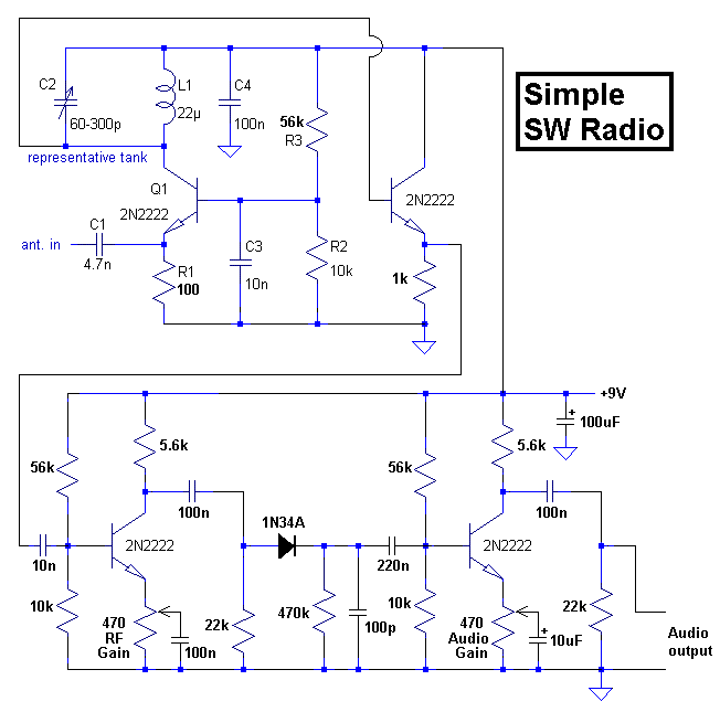

I wanted to keep the input impedance of the emitter-follower as high as possible.
I've changed it so that the DC for the base of the emitter-follower is divided down, but used bootstrapping to keep a very high impedance (even higher than before) and very little signal loss:
You can't bootstrap an emitter follower's base that way.
A better solution is to put about 10k between VCC and the tank, bypass the upper end of the tank to GND, and direct-couple the emitter follower like you had it originally.
Also - a 2N2222 has too much Cob to get good bandwidth with a 5.6k load.
A better choice would be 2N5179, or any number of more modern types.
Or you could increase the current in the 2N2222.
Actually, I have been wondering why our OP picked 2N2222. Not a great choice for an RF amp, even at 4MHz. I am guessing that he has one or more of them. :)
