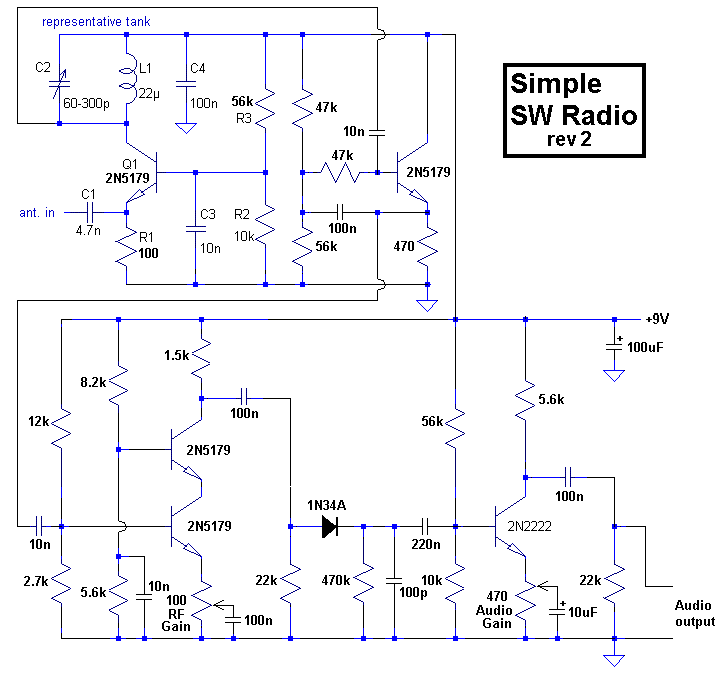

In my "super simple SW crystal radio", I fixed the bootstrap, used RF transistors, reduced the value of some resistors and used an RF cacode pair of transistors. :lol:
Thank you audio guru! I will copy that schematic and give it a shot. I played with the tank circuit yesterday and I pulled in WWV hawaii as well as another talk station. I heard a couple others also, but they were to faint to identify.It helped tremedously to bypass the positive end of the tank,it almost doubled the clarity!(thanks Ron!) I have built a new antenna, a horizontal 5 meter,painted to blend in with the living room wall(kinda'),my wife loves that. Even though it only runs 1 meter down to my bench, I still used a shielded cable. I am hoping that will help somewhat with my input.I will probably have the radio built by Thursday, again I will post the results. I appreciate everyone's time and help.
I like it! - But I like this emitter follower biasing scheme better (fewer parts). The tank has millivolts of RF across it, so Vce on Q1 doesn't need to be high. The 1k resistor in series with the tank also effectively decouples the tuned amp from the broadband amp, reducing the risk of oscillation due to poor power supply decoupling. In fact another RC on the cascode amp power supply side might not hurt.
Audioguru, I removed your title block, just in case you were attached to it. :) You can add it back if you make more changes. :D
Thanks again! I probably would have oscillation problems because of the way I'll lay it out. I've taken to cutting my own circuit designs out of thin copper plate, and for this one I will also need to cut out a ground plane for the top side of the board as well. This will be a few hour adventure, as I will likely superglue myself to random objects on my bench several times before it's over. I will probably go with the latest revised circuit for that reason. So basically, any frequency I set the tank for, I will pull it in? I built a nice, 22uH coil today with taps down to 5uH. I have also upgraded my capacitor network for a tunable range of 195pF to 237pF with some ceramic capacitors to give me better station seperation. My coil has 10 taps, so there will be some band overlap. I am guessing I should get from 2.2MHz up to 5MHz.I also am making a slow-motion dial, that should help too. I will use shielded cable to link the tank to the circuit board, using the ground to help eliminate interference, and my capacitor network is also laid out on a small piece of circuit board to cut down on the effect of all the leads sticking out everywhere. Will this new tank set-up work with the revised circuit?
I duly noted the change of R1 to 470 ohms,and my parts will be available for pickup in 2 hours.I might be able to build this thing tonight. I'l let everyone know how this thing perfoms,with my crappy layout,at least. But I also ordered 3 times more parts than I needed in case I mess up the first one!

Well, I switched the power supply to 8.5V,double checked everything on the board,the only thing that could be preventing the thing from working is the lead orientation on the 2N5179's. I found a site with a picture of the leads,but it was a 2-dimensional circle with 4 leads and the tab on the case was in the 8 o'clock position. I assumed it was a view from the top, but now I'm not so sure. It showed the emmitter at the 9 o'clock position, and the sheild at the 6 o'clock position. The base was at 12 and the collector was at 3. Anyway, this simple shortwave set is turning out to be everything except simple. It would be a simple matter to just keep testing different configurations, except I would have to adjust all 4 2N5179's with each try, and maybe toast them in the process. I only bought 10. If anyone knows the secret lead configuration to these suckers, please don't be shy!
