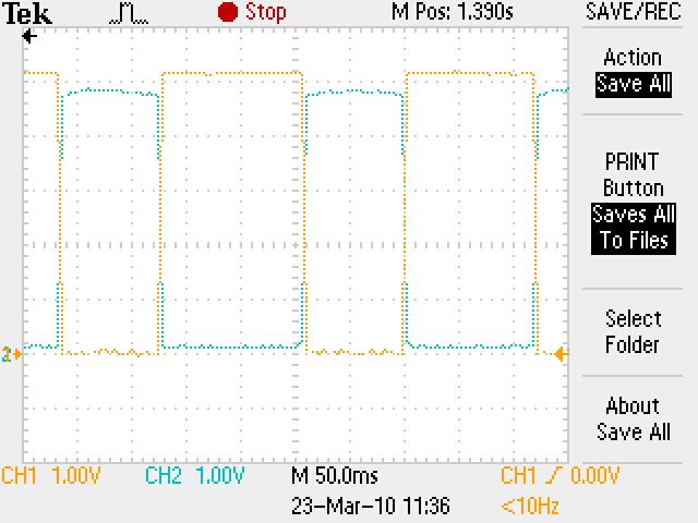

The sensor circuit setup has tested fine so far (although i have not actually put all 8 in action with the code wheel yet). I originally assumed I would need a schmitt trigger to ensure a clean, reliable digital signal (to send to the microcontroller), however the image below shows that perhaps the 7414 hex schmitt IC is not required? In the image below, the blue waveform is without the 7414 hex inverter, and the yellow is the conditioned signal outputted from the 7414 hex schmitt IC.
Would I be best off keeping the 7414 IC in place? or would leaving it out offer me a saving in power consumption (for 8 sensors I would need two 7414 IC's)?

Looks an interesting project.
I would use HC or CD CMOS logic devices, for the much lower power drain than standard TTL.
The 40106 or 74HC14 or 74HCT14 are low power CMOS Schmitt gates.
Looking at the image it shows a time interval of 50mSec, which will not show a fast rise time signal very well. I would recommend using Schmitt gates to clean up the signal edges.
Depending what type of data connection you plan to have from the PIC will determine the PIC type, staying with a 5v system IMO is the best way to go.
You could drive the project from a small SLA 6V battery, using a low voltage drop out 5Vreg.... for weeks if need be.:)

Being that it's an absolute encoder, and not a sequential one, I wouldn't think that edge quality would be all that important. I doubt the error would be significantly worse if the sample was taken right at the edge transistion. You're gray conding already took care of most of the error.
Just a thought....
You could save a lot of power by turning the LEDs off until you want to take a reading. And BrownOut is right, if you take a reading on the edge its value doesn't matter with a gray code. That is, as long as you aren't clocking anything with that edge.
After giving this a little more thought, I'd go ahead and use schmitt gates, at least on the front end. Although not required for encoder accuracy, they would produce definite levels for your cmos logic, which tends to just work better that way.
Yes after testing yesterday, I will be using a low voltage hex schmitt interver IC. made it rock solid with differing distances and code disk thicknesses.
