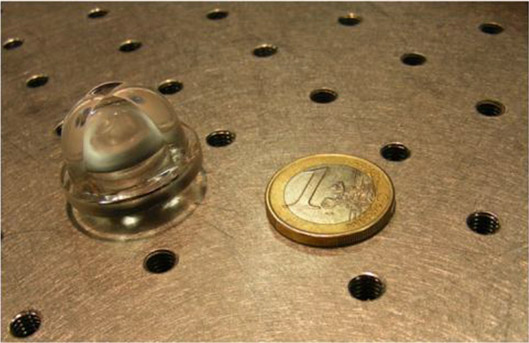

Found the leds... the same used in christmas, concave top
---->https://www.totaloutdoorlighting.co.../led-christmas-lights-5mm-blue-green-wire.jpg
The phototransistor could be a solar cell... so far.
----> **broken link removed**
Seen them in TO-5 package... cannot find those now
In wide angle:

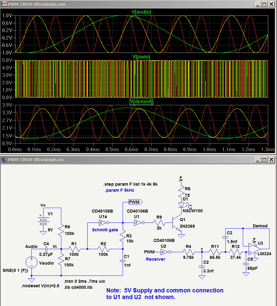

Below is another option which uses a simple PWM circuit to modulate the LED.
It consists of a CMOS relaxation oscillator whose pulse width (and somewhat the frequency) is modulated by the input audio signal.
The output PWM varies from about 50kHz to 70kHz with the component values shown.
The audio is easy to recover with a simple low-pass filter as shown in the bottom right of the schematic, which is a 3rd order, Sallen-Key active filter with a 10kHz corner.
The PWM input would normally be the output of the photo-detector circuit (not shown).
The simulation is shown for input frequencies of 1kHz, 4kHz, and 8Khz.
The linearity is more than adequate for voice, with the input to output distortion being about 1%.
The output has a slight 0.5dB peak at 8kHz due to the 1dB ripple Chebyshev filter.
  • PWM CMOS Ultrasimple.asc

Feel free to substitute the single power supply op amp of your choice. :rolleyes:
How can PWM be called Amplitude Modulation?
There's no change in amplitude of the carrier.
It's a form of pulse modulation, not amplitude modulation.
The IR amplitude is modulated by the carrier frequency of the PWM. Then the PWM Frequency Modulates the carrier frequency.
