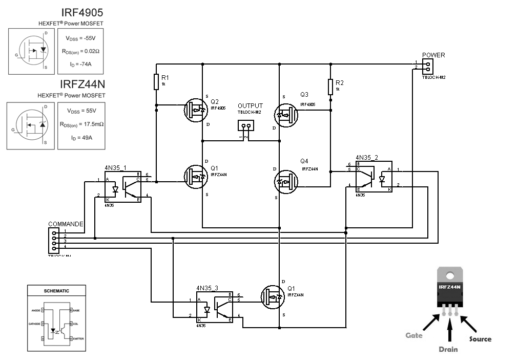

opto isolated h bridge PCB design
With that circuit, the options seem to be full speed either way or brake - I.E. motor shorted.
Also, isn't 10k a little high as it has to charge the bottom gates when the opto is off.
"I don't think the design above lends itself to PWM." sorry i didn't understand this.
When one side is on, the motor turns one way... When the other is on, the motor turns the other.. If when they are both on it free wheels, then PWM may work... If when they are both on the motor brakes ( stops quick ) then PWM wont work..

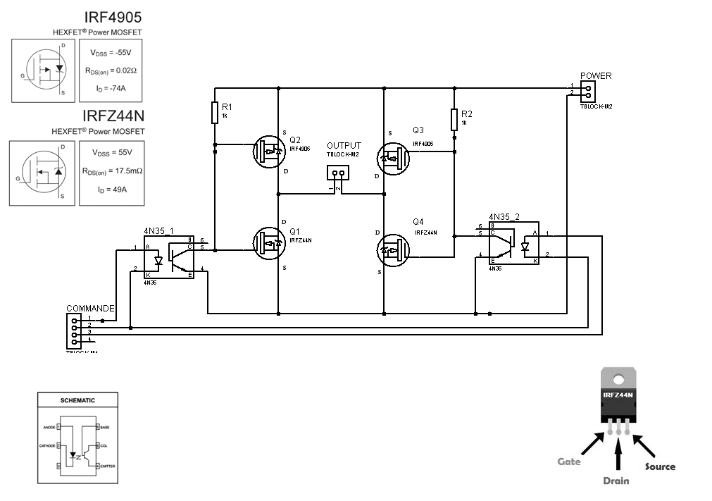

I tried the last circuit
When giving: high low low the motor turns in the first direction
When sending: low low high the motor turns in the other direction
But the speed of the motor is very low, i measured the voltage and found it less then 1 volt.
this is the circuit i have now
when i try simulating it with Proteus (adding and Arduino UNO in place of inputs, and a motor in output) i get this errors:
In your schematic, Q2 and Q4 are upside down..
that was the problem!
thank you very much
the circuit is now working
what about pwm?
i just add it like the 1st circuit?
How much current is the motor taking... The original circuit had a PWM controlled ground.... That means another optocoupler..
To check if you can use PWM on the inputs.... Take both optocouplers high ( high low high ) and see if you can turn the motor by hand easy.. If not it's on brake... Then try low low low and see if you can turn the motor by hand...
Or the way the original should have been.
