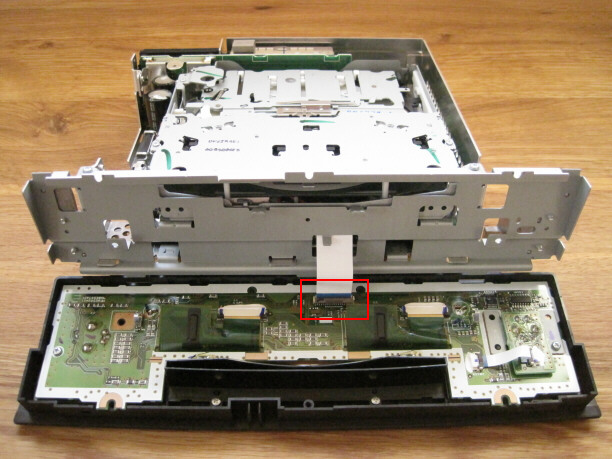

Hi, I would like to try to play with Optrex 323 1867 (rebranded as KYDE 3232351) monochrome display (256x26 pixels).

As I understand it contains of 2 displays, each has 34pins and contains 128x26 pixels. For start I would like to control one of them. I have the board from which display was taken. It has single 32pin connector to which all display and button data flow go.
I have analyzed the board and identified which pins go through that connector:
Display pins -> (board connector) Meaning

So I did further investigations. This display contains of 2 256x13 pixel displays.

More investigations:
I am able to change contrast from original device, but I don't observe any voltage drop in any of the power or other pins. Does this mean that contrast could be sent as a command not as a separate pin input?

Display has "Chip-On-Glass (COG)" (those black spots at the bottom), so it has controller built in. There is no other chip names on it only (Optrex 323 1867)
So I believe "Renesas" is working as driver and display has controller built in. Not sure how MC74VHC541 Bus Buffer chip impacts this, but maybe its not that important?
2. What is the product that this comes from? Search for it and any other numbers or inscriptions or identifying marks that you can find. Sometimes you may not find somthing in a search because you are not using the right terms.
This product comes from car radio "BMW professional radio" (2006-2013 year). I think they intentionally do not publish documentation of product display, I dont think companies want that consumers would mess with their products?
