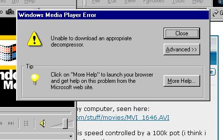

Has anybody been able to successfully download this ?
well i dont know ...
What is it anyway?
