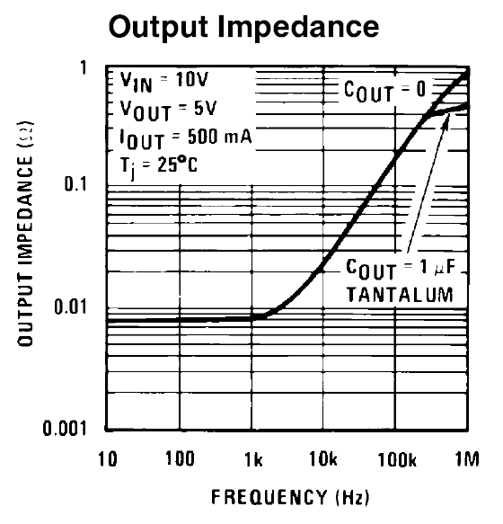

78XX regulators also have high gain error amplifiers (although it may be less than LDOs). They just don't have voltage gain in their output transistor. It would be impossible to get milliohm-level output resistance (see graph below from Nat'l Semi datasheet) without feedback.

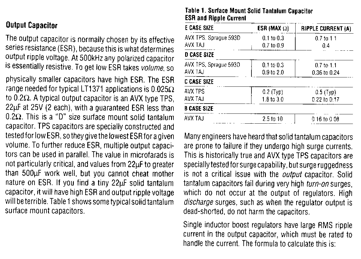

I'm Presently doing some design work with an LT1371 Switching Regulator.
In the Data book there is a Good write-up about Tantalums.
Particularly Interesting is the Last Paragraph concerning "physical size verses ESR".
I did some ESR Tests on the tantalums I have, using my Sencore LC102 Capacitor/Inducor Analyser. It Definately appears to be true.
Physically Bigger tantalums with the same voltage and capacitance ratings, have Lower ESR.
Thank chemelec, that backup what I said about it was inrush that kills Tants
