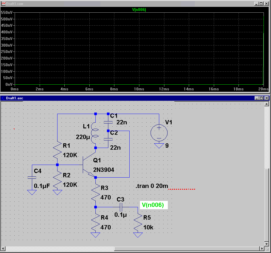

I am working on a beat frequency oscillator metal detector. The rest of the project is working properly. The mixer, filter, daq modules, and such.
I can't manage to get this oscillator working. It is a simple oscillator. The only difference on the other one to produce the frequency is I wind my own coil. Neither of them oscillate at all. Any ideas or something to try to change. Schematic of one oscillator attached.
Sorry, 220uH is the inductor if not visible.

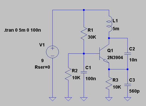

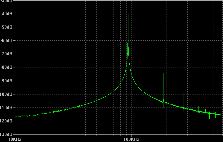

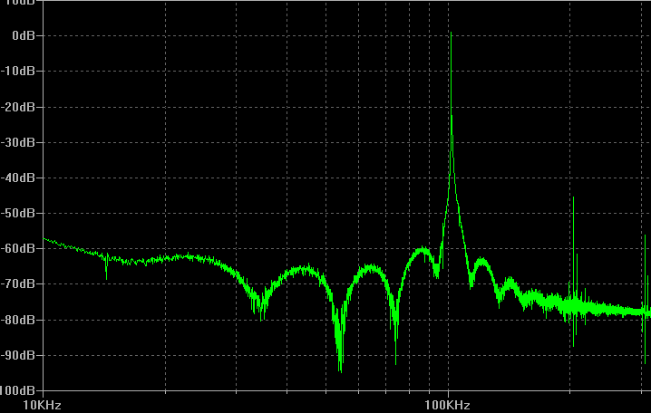

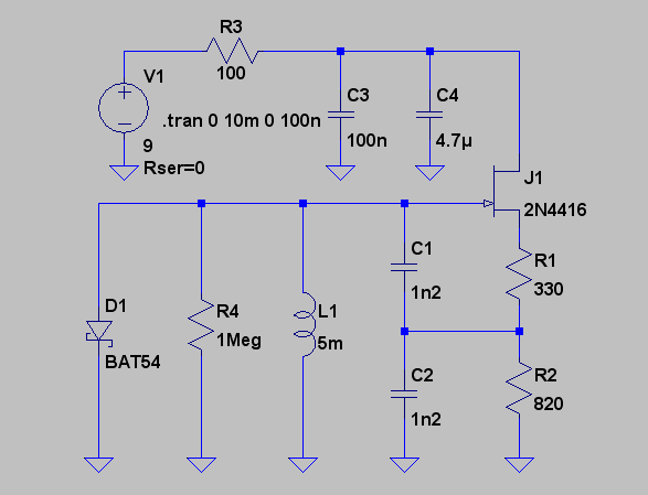

on1aag said:
All my simulations seem to be working, maybe there's something
wrong with (me or) my simulator. :D
on1aag.
My inexperience in using simulator. :p
It turns out I just use the ".tran 0 20m" .op command the circuit does not seem to oscillate. See image. However, it oscillates normally after I added the extra parameters similar to yours.
Why would ".tran 0 20m 0 1u" make such a big difference?
You can usually get an oscillator to start immediately by adding the initial condition directive
.ic i(L1)=1u
or something similar, to your schematic.
You can also usually get it to start by switching your power supply on rapidly
PWL(0 0 1u 9)
instead of assigning it a DC value.
BTW, this circuit oscillates in simulation without the base bypass cap.
Thanks Ron.
Tried the above simulation with each of your suggestions and the oscillator now starts up every time.
Nigel Goodwin said:
But would you ever build a common base circuit without one? :D
I probably wouldn't have even considered the possibility that it might work without one.
