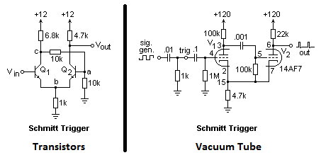

Only on a solid state O scope , it uses schmitt triggers , not on a tube O scope
You are absolutely WRONG! See my attachment.

The Block Diagrams on an Tube O-scope is different than a Block Diagram of a Solid state Oscope, what are the differences?
I posted actual detailed schematics of Schmitt triggers, not simple block diagrams.
They both do exactly the same thing. They produce a pulse that sync's the horizontal sweep oscillator. A sync pulse can also start a horizontal sweep.
A tube Sweep Generator is different than a solid state sweep generator, how so? are they both linear or other?
Of course both are linear. The trace sweeps across the screen at a steady speed. The horizontal oscillator produces a sawtooth waveform on both of them.
The very fast drop of voltage of the oscillator is the retrace.
