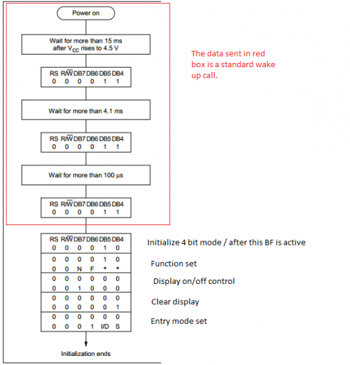

Change your init routine slightly
This is as correct as I can get it... I can't test it until tonight.
Proc i2clcdbegin()
    WaitMs 20
    I2CWrite sda, scl, 0x4e, 0x34, 0x34
    WaitMs 1
    I2CWrite sda, scl, 0x4e, 0x30, 0x30
    WaitMs 5
    WaitMs 1
    WaitMs 5
    WaitMs 1
    WaitMs 5
    Call cmdwrite(0x2c)
    WaitMs 1
    Call cmdwrite(0xc)
    WaitMs 1
    Call cmdwrite(0x6)
    WaitMs 1
    Call cmdwrite(0x1)
End Proc

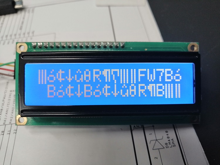

copied my code. Below.
I have turned off three code lines.
But with this the display fails and no longer shows any sign or image.

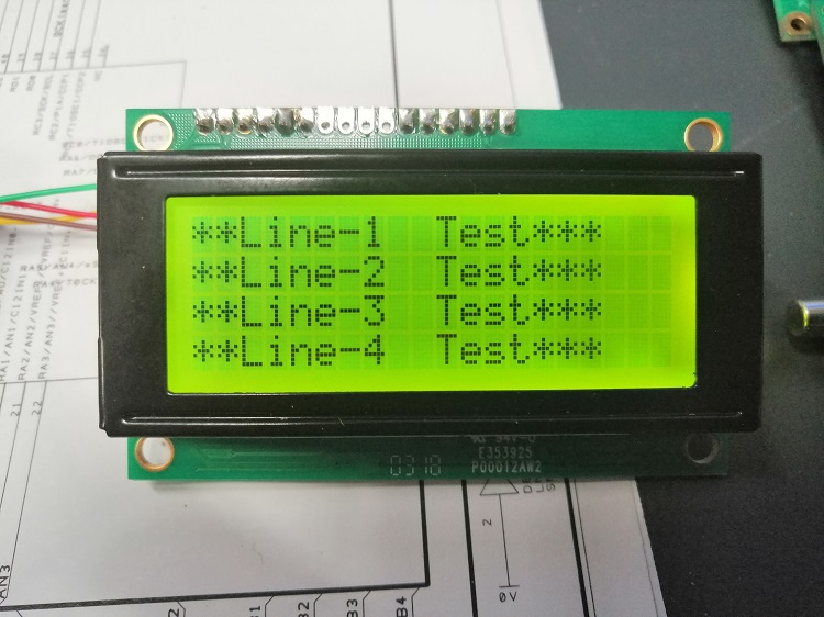

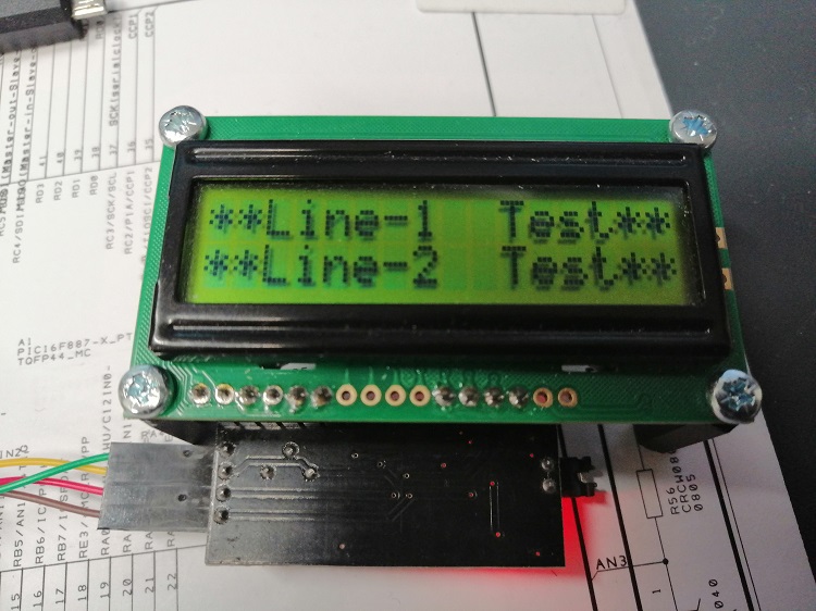

Just before you sent that new code.
I have done another test with another 2 line display.
I used one and the same code for this. So the green display is running well and the blue one is not.

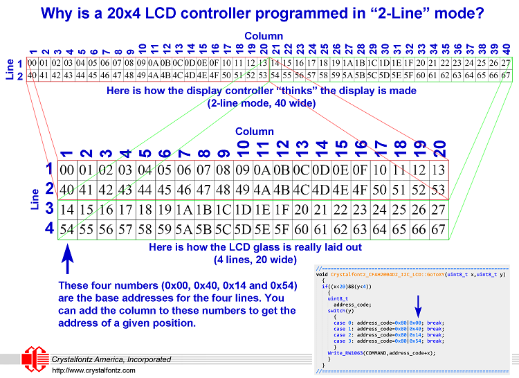

Then it must go wrong somewhere here? Or am I wrong?
Call i2clcdbegin()
Call cmdwrite(0x80)  '0x80 = 1e line
Call printstr1()
Call cmdwrite(0xc0)  '0xc0 = 2e line
Call printstr2()
Call cmdwrite(0x94)  '0x94 = 3e line
Call printstr3()
Call cmdwrite(0xd4)  '0xd4 = 4e line
Call printstr4()
What did our other colleague mean by this?
So the address of each line is 0x00,0x40,0x10,0x50. These numbers need the top bit added before being sent as a command.
I regularly come across these addresses in datasheets. (0x00,0x40,0x10,0x50.)
But if I use it in this program, it doesn't work either.
Why do you use these hex codes in this program? (0x80,0xc0,0x94,0xd4)
That is a piece that I still do not fully understand
The address starts at 0x80 as you know this is the starting figure.. So line two is 0x40 add together = 0xC0.. Line three 0x10 + 0x80 = 0x90... etc.. Nothing magical...

Data sheet said that you must send three sets of 0x30 then the function command 0x2C.. but the command write has upper and lower so 0x33 is seen as two and then I usually send 0x32.. then finally 0x2C... For most displays this works..
Finally I come across a list that explains a few things.
This is the explanation for 4x20, but the list can also be used for 2x16.
I assume.
I only half understand what you are saying here, but I will try to figure it out.
I now also understand that the problems cannot be caused by this.
Because if this address is incorrect, you will see in the display that the beginning of the sentence starts at a different location.
Hi Ian,
You don't believe it but the problem is solved!
See below the code!
What makes the big difference is the reversal of the clear display and the incrementing.
So first "clear display" then the next step.
As can be seen in the previous diagram.
Proc i2clcdbegin()
    WaitMs 20  'wait time for display
    Call cmdwrite(0x33)  '33
    WaitMs 5
    Call cmdwrite(0x32)  '32
    WaitMs 1
    Call cmdwrite(0x2c)  'LCD function set 4 bits and two lines (there are always two lines.. They are adress 0x80 0xAF and 0xC0 0xEF)
    WaitMs 1
    Call cmdwrite(0x0c)  'Display on/off control
    WaitMs 1
    Call cmdwrite(0x01)  'Clear display and set position to first character
    WaitMs 1
    Call cmdwrite(0x06)  'Incrementing
End Proc
I just tested all other displays and they all work now.
Thank you very much for your patience and your help.
I have learned a lot from I2C in recent days.
It's a nice start!
Enough Still to do!
I suspect that the one that didn't work had an original Hitachi HD44780 chip as these were very fussy about initialization order and timing. Most of the newer clones are much more forgiving in this manner. Anyway, congratulations and good luck with the rest of your project.
