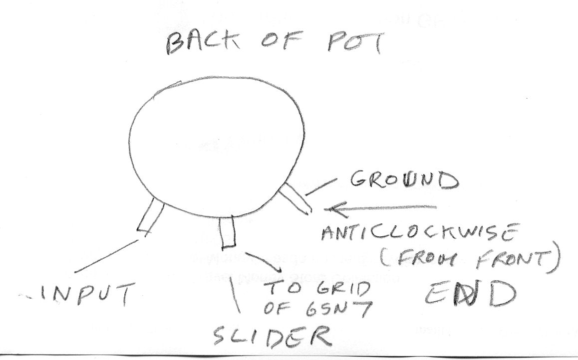

The hum has been significantly reduced by tidying up the 6.3v wires and twisting them however it appears that I have wired the potentiometer wrongly as the volume is going neither up down and the sound in general is just poor, can anyone provide a small diagram please to show which pins that the audio cables from the valve pins 1 and 4 of the 6SN7 and from the rca inputs should be going please.
This is a view looking at the back of the dual gang potentiometer. (I consider the front end the end with the spindle sticking out.)
Both sections of the pot are wired the same way. one for the left channel and one for the right channel. If I remember correctly (As it is over 60 years ago.) the heater windings sometimes had a centre tap that could be connected to ground. You could achieve a similar effect by connecting a 100 ohm resistor between each end of the heater winding and ground. If the noise is more of a buzz than a hum connecting a small capacitor (Say 10 nF) across each diode of the bridge rectifiers might help.
