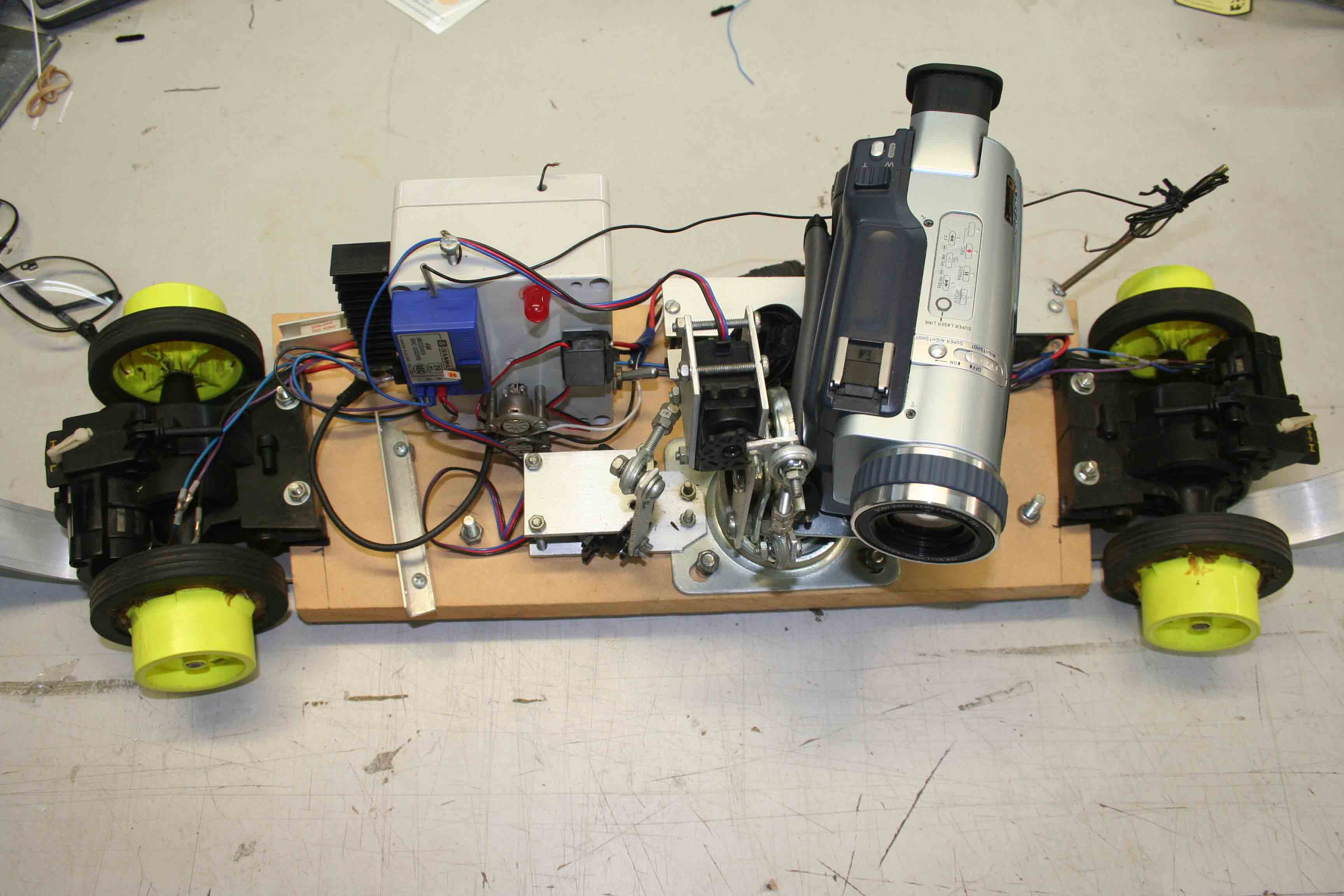

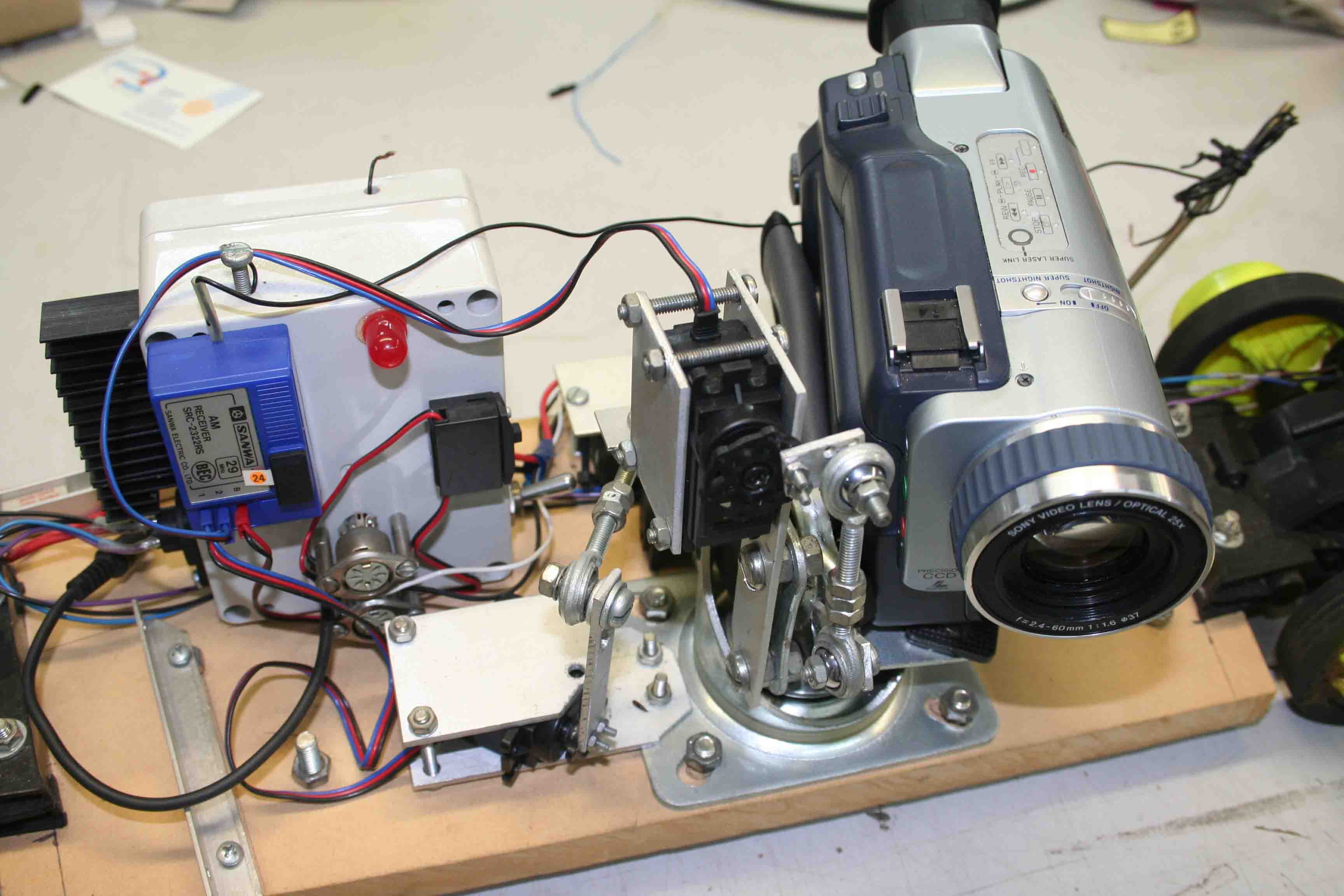

I wanted to do a music video for my band, in a very small room, so I fitted a remote controlled video cam on 2 radio controlled cars (2 cut off and joined, the motor power ends, the others motor polarity reversed) and fitted 2 of the steering servos as pan/tilt controls. I then made a circular track near the ceiling for it to run on, connected to an arm on a gimbal in the centre of the ceiling, so that it tracked a circular path without using the steering servos.
I also fitted a video transmitter to the cams output so its output could be viewed on a remote TV, for an operator to see the results of pan/tilt/speed adjustments whilst adjusting the RC controls in real time.
The Cam of course recorded the event on internal tape for later editing.
Several takes were done fast/slow/fwd/rev and edited in Adobe premier pro.
The cams internal stability function smoothed the rolling bumps.

The 360 deg rotation around the lead guitar is really slick. I know you had two cams, but the 360 rotation looked seemless. How did you do that?
No, theres only 1 cam, it sits on the RC controlled car and drives on a circular 360deg track attached to the ceiling. Round and round it goes, with speed/tilt/pan contol, connected to an arm at the centre, so it tracks without falling off and trashing everything ;-)
Damn, that is cooler than Shiat...Good work :)
BTW, the whole thing is powered by an on-board nicad pack, no wires, all wireless control video send, so endless rotation was no problem.
That is a klunky looking contraption, but the result are great, I am very impressed. Your quite a clever fellow. Was the roaming RC distracting during the gig? I would guess your cam unit had 5 minutes of battery max... So you had one remote with forward and pan and tilt. Hats off to the operator :)

The cam batt lasted the usual 30mins or so, it was only powering itself. The servo used the external pack. We mimed the song each time, to a pre recorded track, way to hard doing it each time live in time ;-). Yes, your average RC remote has speed (used as is) and steering controls seperately (come to think of it, it might have been a plane control, which has extra servo channels, ie L/R and altitude)
