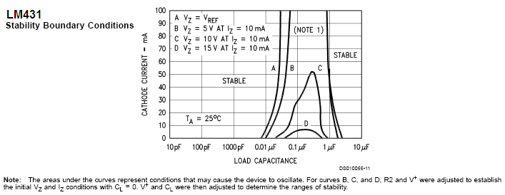

In National's datasheet, they show the value of capacitor and output current that cause the LM431 to oscillate.
And how could one get around this? Use a 10uF cap then?

As I've already said, and the graph audioguru posted shows, you don't need a capacitor at all!.
You're probably too young to remember neon oscillators?, but adding a capacitor across the TL341 looks exactly like one - and from audioguru's graph, it looks like they oscillate in exactly the same way?.

First, Nationals version of LM431 shown is only a region of concern for nationals part. Other companies make this part and they may be more or less immune to osc for a particular value of output C. You'll have to check for specifically the part you are using.
And while having a capacitor doesnt seem to be critical, sometimes it is a good idea to improve the transient response, filter noise etc... as long as you stay away from the region of oscillation, it will only help maintain a stable quality reference voltage.
You probably have much bigger problems to worry about keeping your design safe. Oh yeah, if you dont want to risk it, get a different reference. Plenty of manufacturers make oscillation free references with or without caps.
