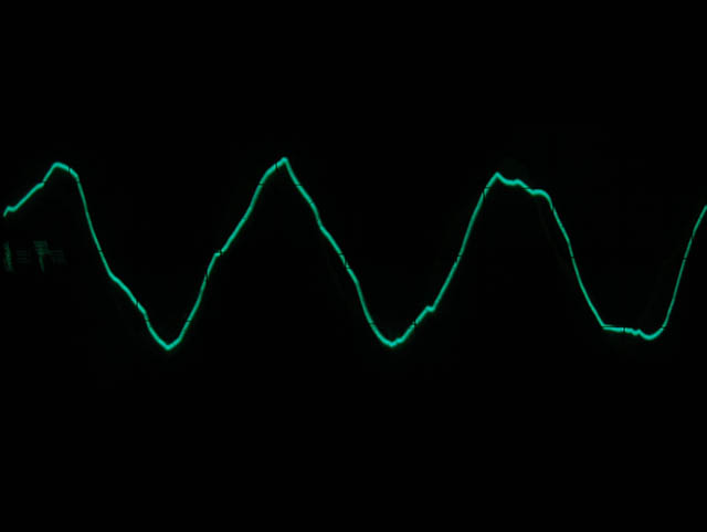

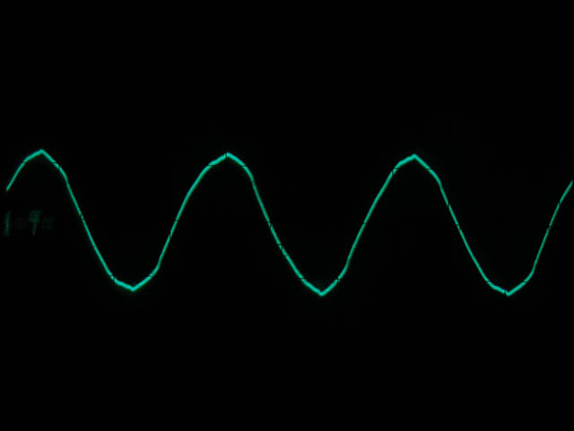

Attached is the sine wave. As you can see it is approximate as it's only 4 bit but should become smoother with filtering.
Thank you for the links about sine wave/dds generation, these ones I haven't seen before (I guess google sometimes misses the "good stuff"), and for the corrected sine wave table.
And I did have the bits/resistors reversed in my 4-bit network so going "backwards" did the trick. I think prior I used a 20 value sine wave table which worked in the old direction and wasn't compatible with the new 32 value table. ;)
I have taken two photos to show the sine wave from a R2R and 4-bit network via a RC filter (50ohm/10uF on both). You can see that the R2R has pretty jagged edges while 4-bit is smoother. This was taken in the DSO mode with avg of 2 on my PM 3394.
