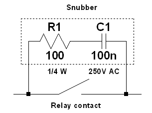

Looking again at the whole ozoniser system and bearing in mind that at least the relay switching the variac is handling an inductive load (not sure about the ozoniser), it would be advisable to add a respective snubber circuit across each of the relay switches. Like this:

The AC caps are on the way-thank you for the snubber refinement. We have plenty of room on that board.

Should we wait until the snubbers are installed to test run the radio (in place of the ozonizer) the variac and blower?
BTW, I want to mention this because you might find it interesting Alec-D1 still shows 1976 or so with the DMM probes reversed.
Thanks again for that super schematic, you’re the best!
The snubbers protect the relay contacts. Your choice. They are not likely to fail in week used 1x/day.
The beefier the contacts ], the less likely failure.
