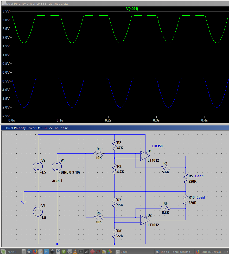

Each of the op amps shown in the attached circuit diagram is powered from differing rails (+, gnd and gnd, -) to produce two identical, but DC shifted, outputs.
In addition, the input signal is referenced to the negative rail instead of ground. There is a reason for this relating to balanced battery drain.
I tried adjusting the offset to each amp with R2, R3 and R7, R8 but canot bring it within range. Can anyone please offer a solution?
The final circuit will probably use LM358's.

If the input signal really needs to be centered about -4.5V, then you will need to add a level shifter to move it within the common mode range of the opamps.
Yes, that works with a few resistance changes. But in your .asc you changed the return on the signal input to ground. How can I make the circuit work with a return to the negative rail as originally drawn? There is a reason I would like it this way. Thanks.

I tried this with a divider across the rails to pin 3 of each amp but could not get it to work. Not enough adjustment possible by simply changing the resistor values. Would you have a sample circuit?
What exactly is the input signal? Maybe you could couple it with just a capacitor.

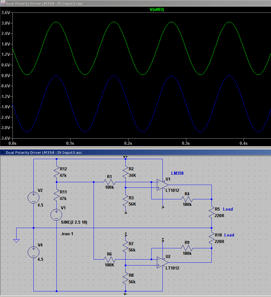

This I think should be what you want, but might need some tweaking of the output offsets to get the output offsets you want.
  • Dual Polarity Driver LM358 -2V Input3.asc

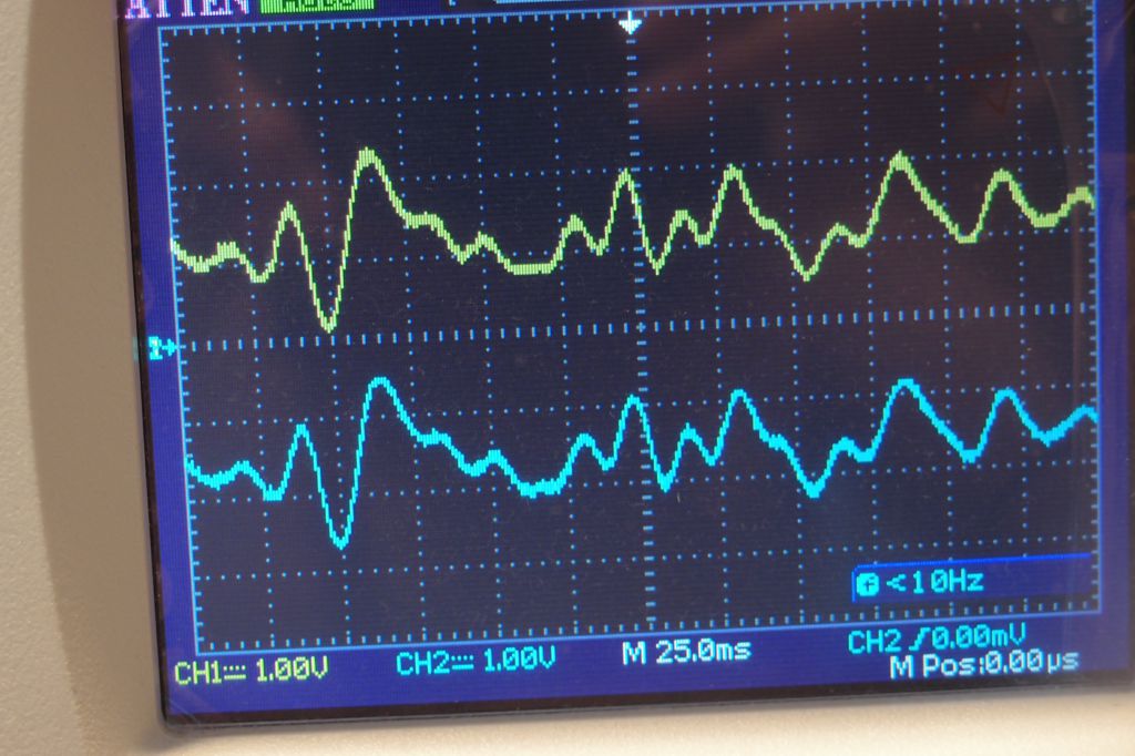

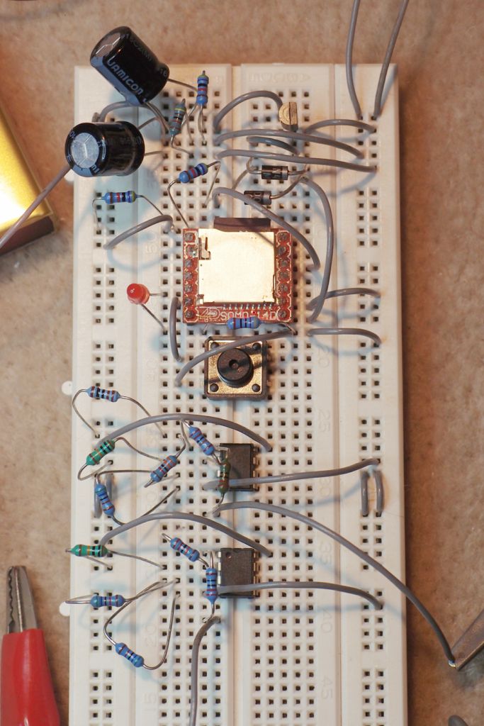

Here is the end result. Pretty good I would say, thanks to your help.
