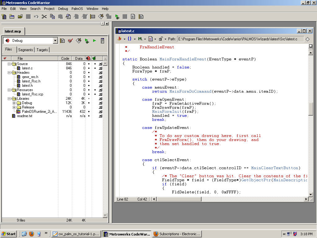

I tried that hotpaw basic but turns out it is basic on the PDA; not really a dev tool,..........in the end i got codewarrior + palm os sdk.
it runs good, compiles and is compatible with the m100 and palm 3 & 5, the sdk provides a "constructor for palm os" which has framework for the palm (alot like VB), and then it has "pilRC designer",, whatever that is,, looks like a constructor too,
but has slot for source code, and tutorial..!
but I am having problems tying it all together(importing ,(and putting my code in!)
heres what a sample code looks like, I just got one question, is this C? (specifically)?
