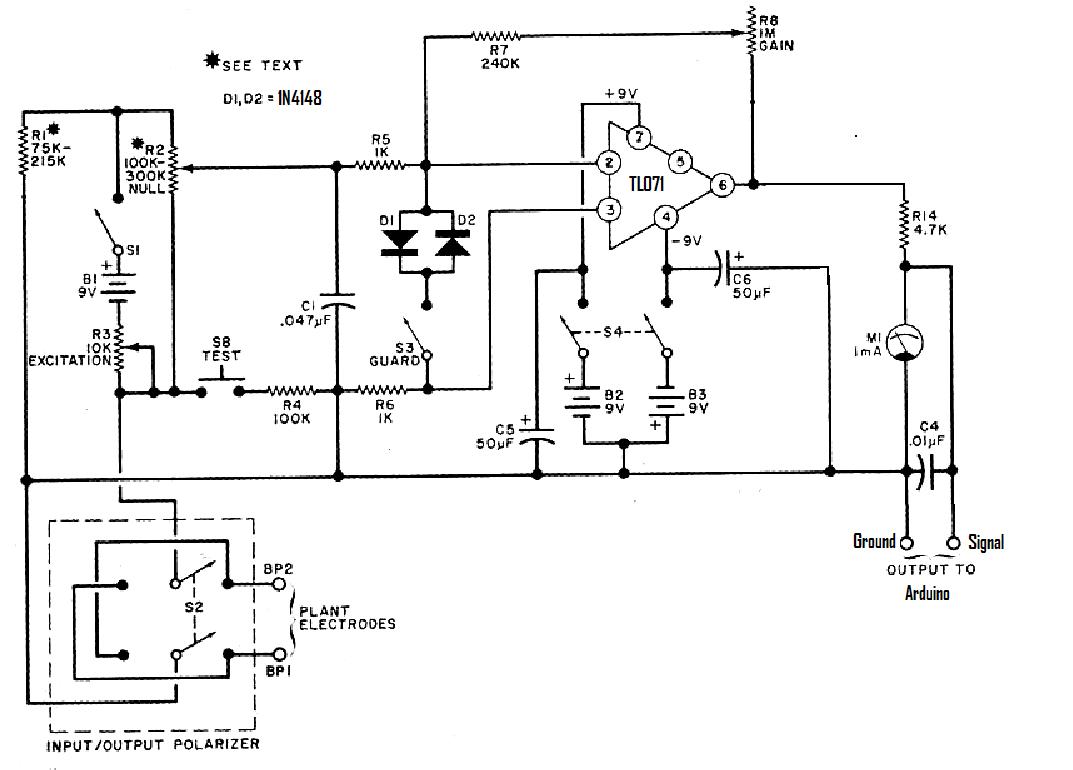

Basically i want to make 6 or these (see below). They will need to run simaltaniously but i am happy to take the reading from the meter one at a time.
I assumed i could use a SPDT switch on each so that i can keep the circuit closed and just divert the current of each circuit through the meter when needed.
Hence why i was asking if i could use a rotary switch, it would be much neater. Can this be done?
As for the power. currently there are 3 9v batteries in each circuit. Ideally i would love to run all 6 off a single power supply but am struggling with the dual power supply. Is there a simple way to turn a 9v single regulated into a 9v dual? I am still very new to this so sorry if my questions seem a little silly.
Edit: ok so it seems i need to run a 9v ac supply then convert that into a regulated +/-9v dc, i will come back to that last.... but feel free to throw in any suggestions
Schematics.....

And another question. I need a 50uf 10 volt cap, the closest i can find is 47uf 16v. I assume the voltage is ok but will i be fine with a 47uf of should i wire another one in series?
The 50uF capacitors are just for bypass. Not critical at all. Anything from 10uF to 100uF will work there. Voltage rating from 15V to 50V will work; not critical either.
For sharing one meter, try this. Get six 1/4" panel-mounted mono headphone jacks like this.
Attach a 1/4" mono plug, **broken link removed** to the mA meter. Connect tip to meter + and barrel to meter-.
Wire the jack "Ground" to barrel, "Signal" to tip. To read one of six circuits, just plug the meter into the jack you want to read.

If not, and i went with your idea would i need to wire the circut closed where the meter would be or will it still function when the circuit is broken? ie when it is not plugged into the meter?
The voltage between the "signal" output and the circuit's "ground" will be effected by the meter resistance. The DC resistance of the typical milli-Amp meter is about 30Ω, so R14 and the meter resistance form a voltage-divider. With the meter in the circuit, the "output to Audurino" will be a few mV, while without the meter, the open-circuit output could be a couple of volts.
If you want the output to be constant, regardless of the meter being there or not, you will have to switch-in a resistor equal to the resistance of the actual meter you are using.
ok well thats thrown a spanner in the works... Although it could be a good thing.... a couple of volts will be a much better reading for what i am doing (it will be read in a pc).... i guess i could drop the meter out all together. ok well back to the drawing board.
