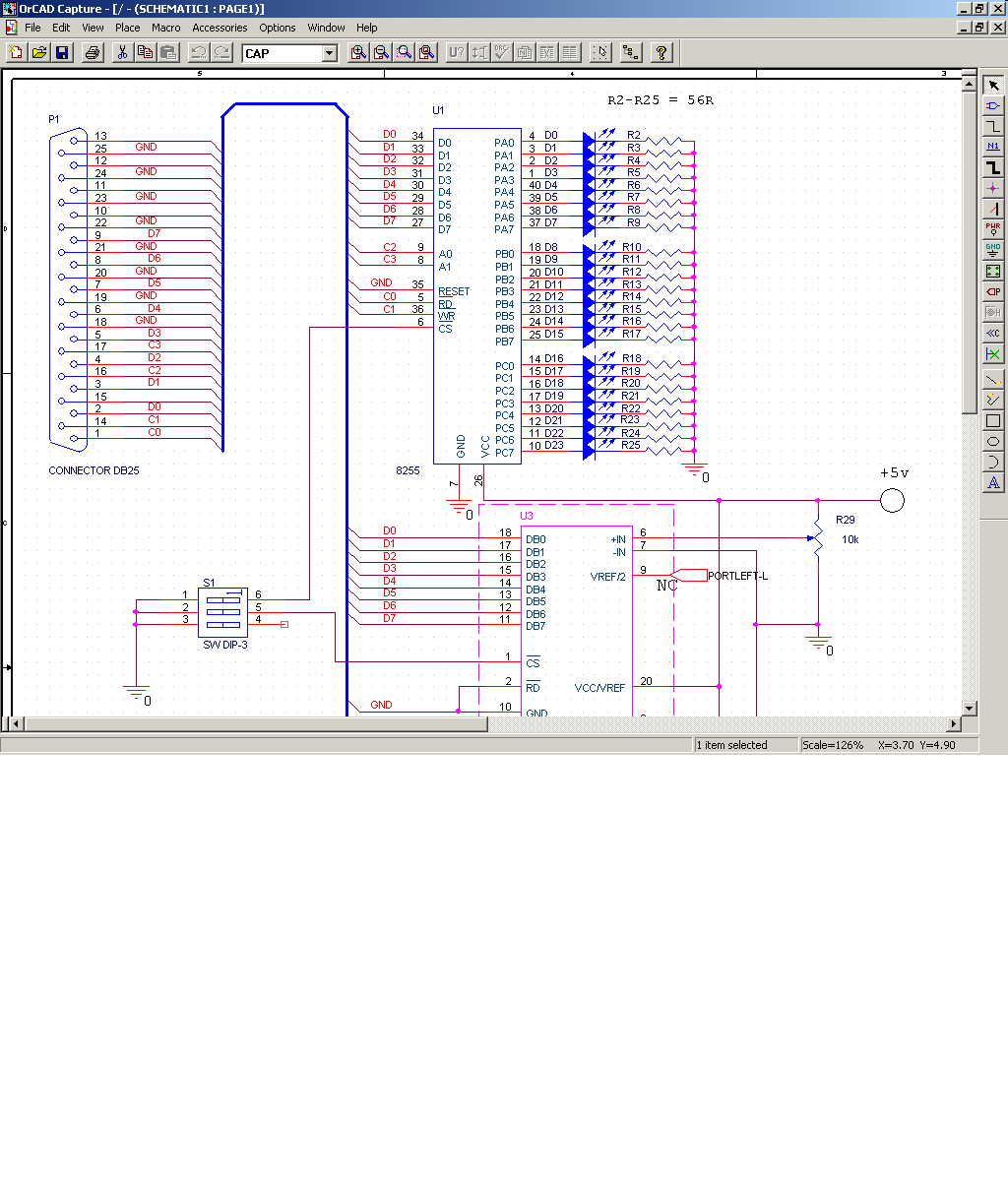

please see the schematic and tell whether it is fine or not?
i have made the hardware but its not working
please guide me

Well, the first problem I see is the 56 ohm resistors in series with the LEDs. The 82C55 can only source or sink about 2.5mA.
The 8255 has some peculiararities to get it started. I found this helpful.

Using an 8255 PPI chip
Well I had the hardest time getting one of this chips to work so I thought I'd post some information on how to use the chip (namely what I was doing wrong).
When working with these chips it is very handy to have a white paper (data sheet) in your hand:
8255A.PDF
Mode 0
Since my application was working with all outputs, I'll assume we're going to work in Mode 0. The basic steps needed to get one of these chips initialized are:
1. power on
2. reset the 8255 using the RESET pin
3. set the write pin (WR) high
4. put the control word on the data bus (selects the Mode)
5. set A0 and A1 pins high
6. set the write pin (WR) low for a very short duration, keeping A0 & A1 high
7. set the write pin (WR) high again
When step seven happens, it causes the chip to "take note" of the data bus and pins A0 & A1. When both of the Ax pins are high, the 8255 knows that the data present on the data bus is a control word and from that data, it goes into the appropriate mode. You only have to do the above seven steps once (on power up), unless one wishes to reset the chip during operation. Then just start from step 2 (since you already have power to the chip). Please note that when an 8255 is reset, all three of it's ports go into input mode.
