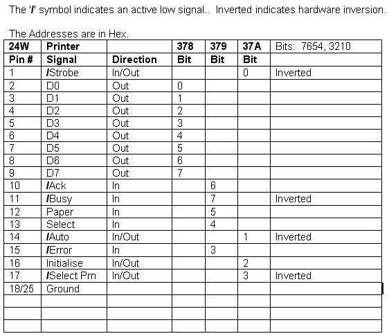

2. According to the table, some pins have and active low signal, and others are inverted. What does that mean?
here is the answer
https://www.codeproject.com/KB/cs/csppleds.aspx?df=100&forumid=21021&exp=0&select=974134
3. There are 8 "IN" on the port. So, if I want to check the state (i.e.) a microswitch in the window, should I connect any of those pins in series with the microswitch, and then (I guess) any ground?
10 /Ack In
11 /Busy In
12 Paper In
13 Select In
14 /Auto In/Out
15 /Error In
16 Initialise In/Out
17 /Select Prn In/Out
yes! that's the way it works. Refer to the above link for more info
here is the answer
10 /Ack In
11 /Busy In
12 Paper In
13 Select In
14 /Auto In/Out
15 /Error In
