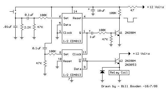

Ok I have made a diagram, I hope its correct
The thing consists of a parallel port, 74LS139, a "X" circuit for each 74LS139 output, and its respective relay.
The "X" circuit and relay should change its state when receiving the pulse from the 74LS139, and keep it while the 74LS139 actuates other "X" circuits
If I try to use the schematic without the "x" circuit, I'll be able to turn on only 1 device at time, so would be a controller with limited utility
hi menticol,
The circuit you have posted, the 139 will not 'hold' the output state.
As soon as you load another address the 'old' 'X' will drop out.

Thank you by your suggestion Eric, but I'm afraid it gets too expensive vs. benefit. Each latch consumes 2 pins of the decoder, so I'm gonna need a lot of cascaded decoders and latches to control a respectable ammount of devices.
I'm been studing the diagram of my 20th june post, about cascading the decoders. I understand more decoders means more A. B, C inputs, and the free pin of the second decoder is used to feed an eventual third decoder, and so on. But I cannot figure out yet.
I have found an interesting dual flip flop circuit, but multipling it times x numer of decoders, no way (even using a hex 74LS174 flip flop, stills require too much adtional components) Anyway I leave it here if anyone could find it useful.

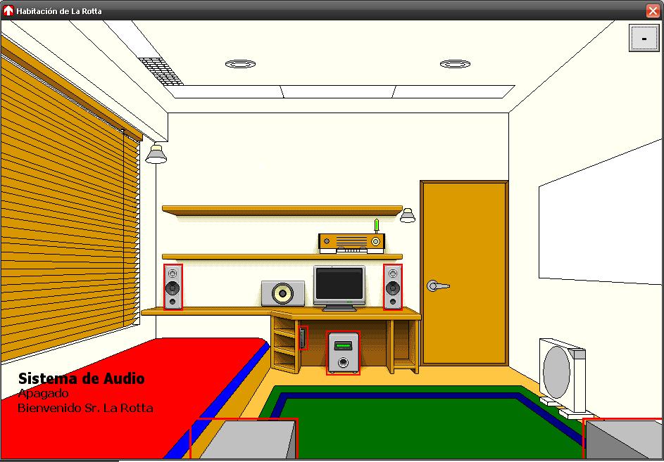

Here is my program, its a simplified drawing of my room (without the dirty clothes and dirt under the bed, offcourse!). Touching the objects sends a signal trough parallel port, turning the thing ON or OFF. Based on inpout32.dll code, found on planet-source-code. Nothing complex.
My last "high technology" advance was adding a dimmer I've found abandoned on my university. The pot was broken, so I wired a resistor to it. When the relay is open, the dimmer's pot resistance is 0 so the room lights shine with full intensity. When the relay is closed, wires the dimmer through the resistor, so the light fades down. With a simle VB mp3 player, the light can be dimmed automatically if some music starts (a geek way to entertain female guests, but may be improved... maybe a solenoid driving the fireplace? hahahaha)

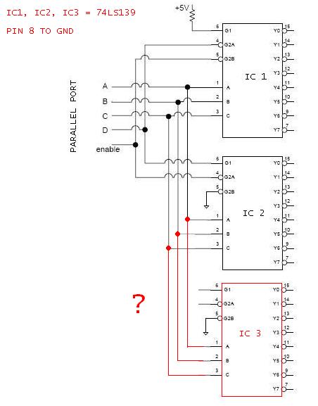

Working with 74LS139 By now, I know how to cascade two of them
But how can I cascade 3, or more?
Thank you in advance
Sorry by double-posting, edit was disabled
Use 3 of the other output pins into a 74LS138, then use the 8 decoded outputs to select the required LS139.
