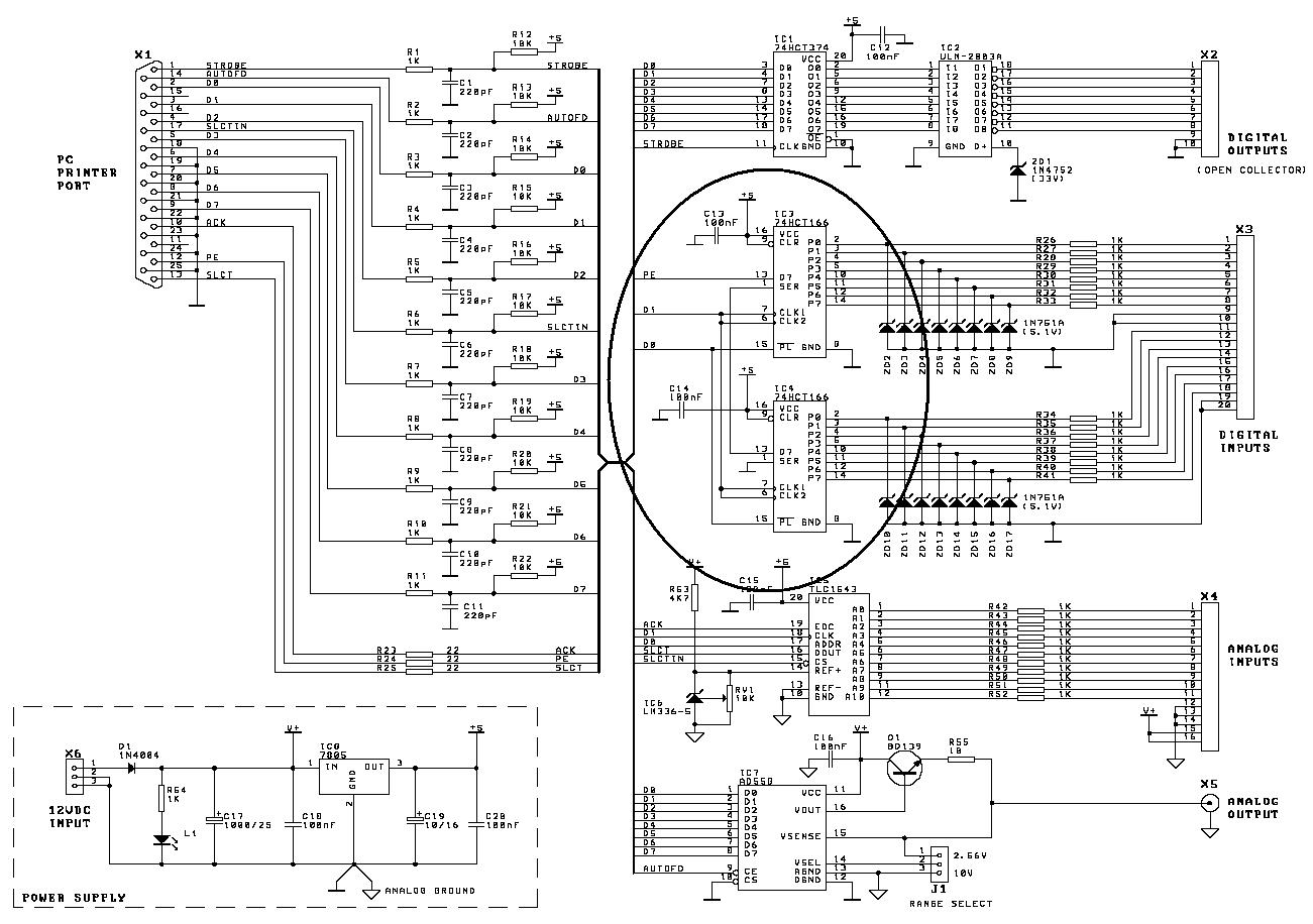

I am wiring 2 74HC166s that will convert a +5V DC signal from 16 push buttons into a serial signal, 2 74HC164s are 'supposed' to convert the serial signal and send a +5V DC signal to 16 LEDs.
I've found lots of schematics on the web for one chip, or the other, but none with the 2 chips used in tandem. I'd appreciate any help in connecting the controlling pins, the buttons and LEDs are a piece of cake, even I can figure that part out.

Ok,
my requirements:
- no LEDs light as long as no buttons pressed.
- when button pressed, corresponding LED lights, turns off when button released.

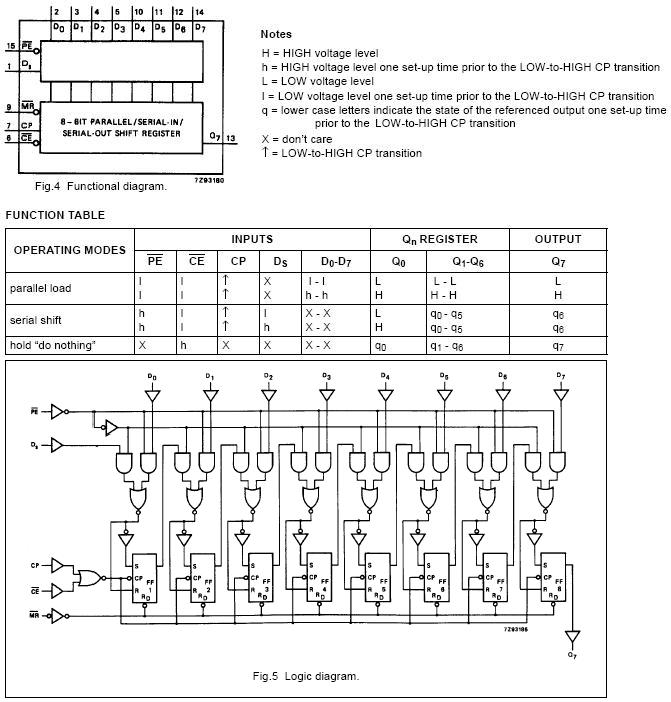

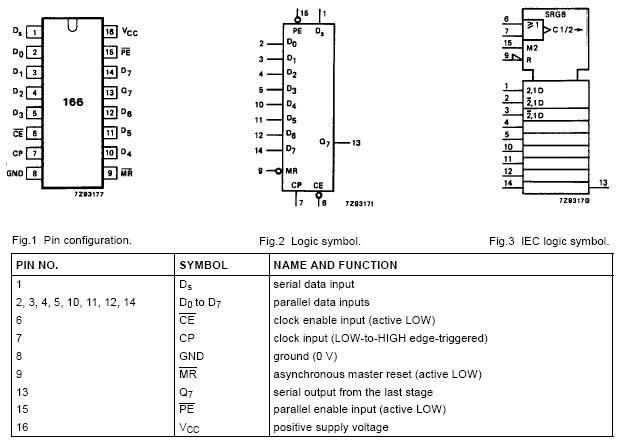

I'm including a schematic of a circuit with a pair of 74HCT166s as well as the pinouts and function.
Robert

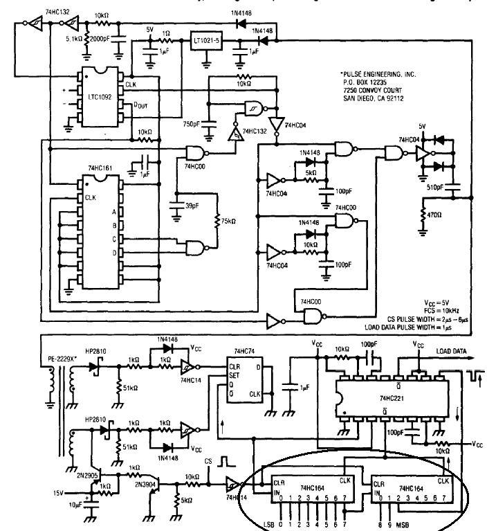

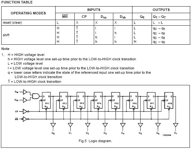

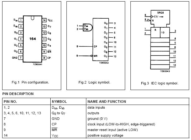

And here is a schematic of a circuit with a pair of 74HCT164s as well as the pinouts and function. You can see that this circuit was not fed by 74HCT166s, so the wiring is different.
Robert
