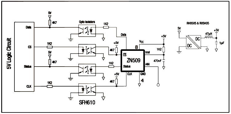

The GPS ZN509 is GEC Plessey 8-pin DIP ADC. I have searched the Net for data and the usual Datasheet Archive but cannot found any additional information. My only hope is someone have a databook that list this part.
Anyone has the pinout information or information on this chip?
