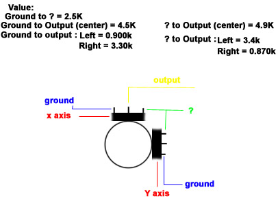

I will try to explain better,
first I replace the 10k pot on the x axis on the stick by the 10k on the wheel. the trouble is the deadzone the stick is 70 degree total and the wheel are 270 degree total , so the little deadzone on the stick become huge on the wheel.
the stick have 2 pot of 10k in parallel one for X axis and one for y axis
Here the value of the wheel pot (10k) in paralel with the y axis stick pot (10k):
Ground to ? = 1.6k
Ground to output center =3.1k
Ground to output Left = 1.640k
Ground to output Right = 2.620k
? to output center = 3.1k
? to output left = 2.680k
? to output right=1.630k
here a pic for the original stick pot:
and i dont know what is the "?" maybe power.. that go to the trigger ? dot and the y and x axis of stick
