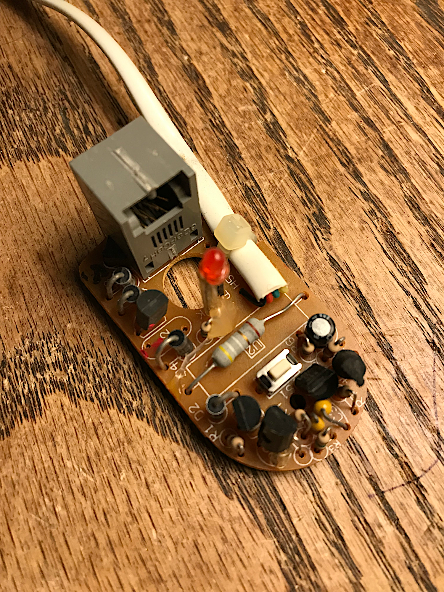

Have you got a picture of the other side of the board?, there's perhaps a SM (or COB) chip on that side. The device pointed at by the arrow appears to be an opto-coupler, hence the heatshrink crimped round it.

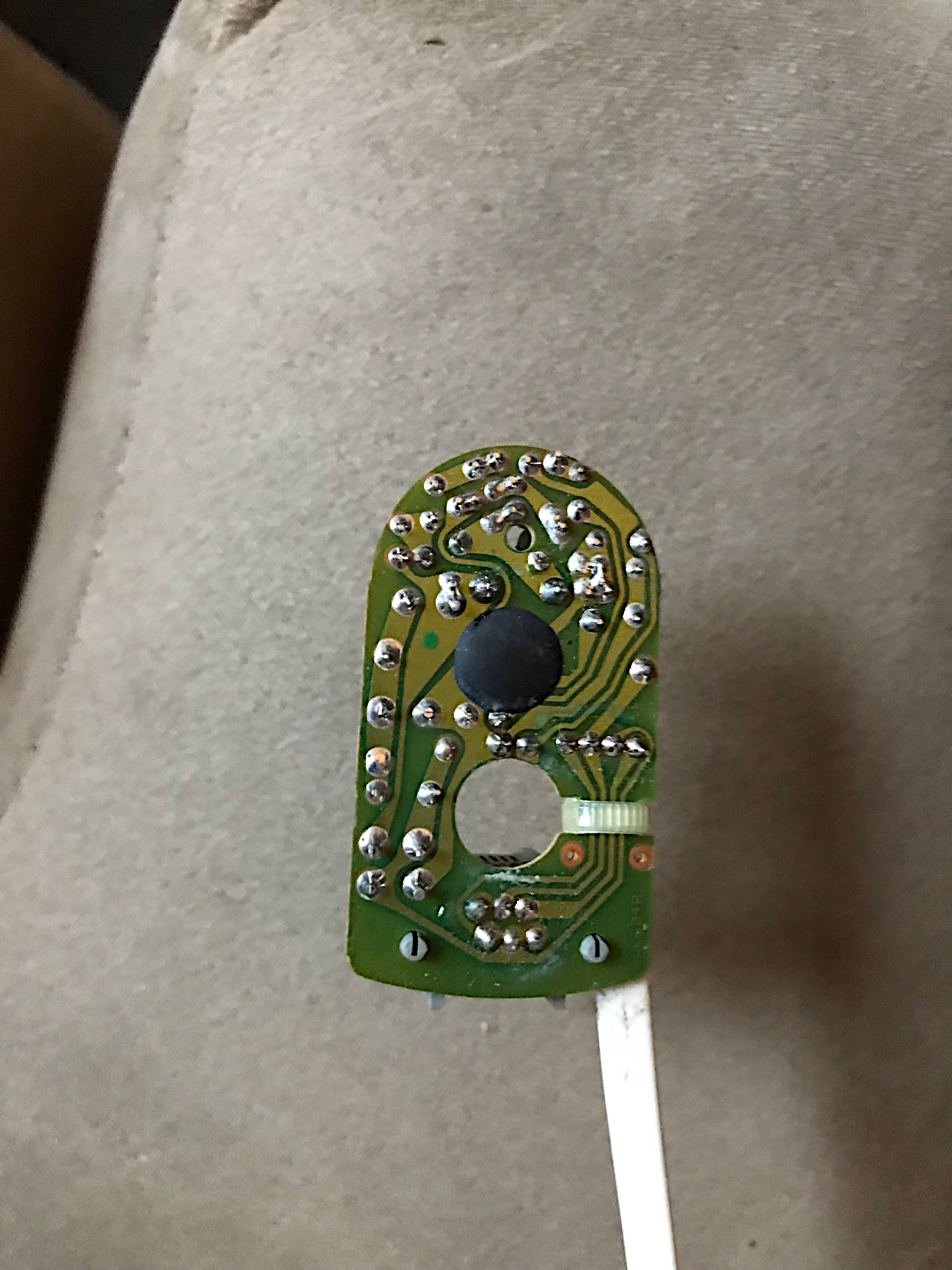

No components at all on the back.
Here's a different view of the front:
I can't see any kind of chip. I can't figure out where the digital file is stored. They still sell these things on ebay and Amazon.
The "chip" is under the black blob of epoxy.
That's a COB module - Chip-On-Board - a low cost type for mass production.
There is a bare silicon IC die inside the black epoxy blob, wired to directly to the PCB instead of being mounted via a lead frame in a more recognisable separate package.
A lot of low cost stuff like electronic toys, calculators and multimeters use that style, as well as such as LCD modules etc.

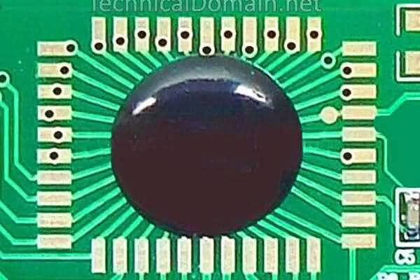

Some also have the pad pattern for a conventional IC as an alternative:

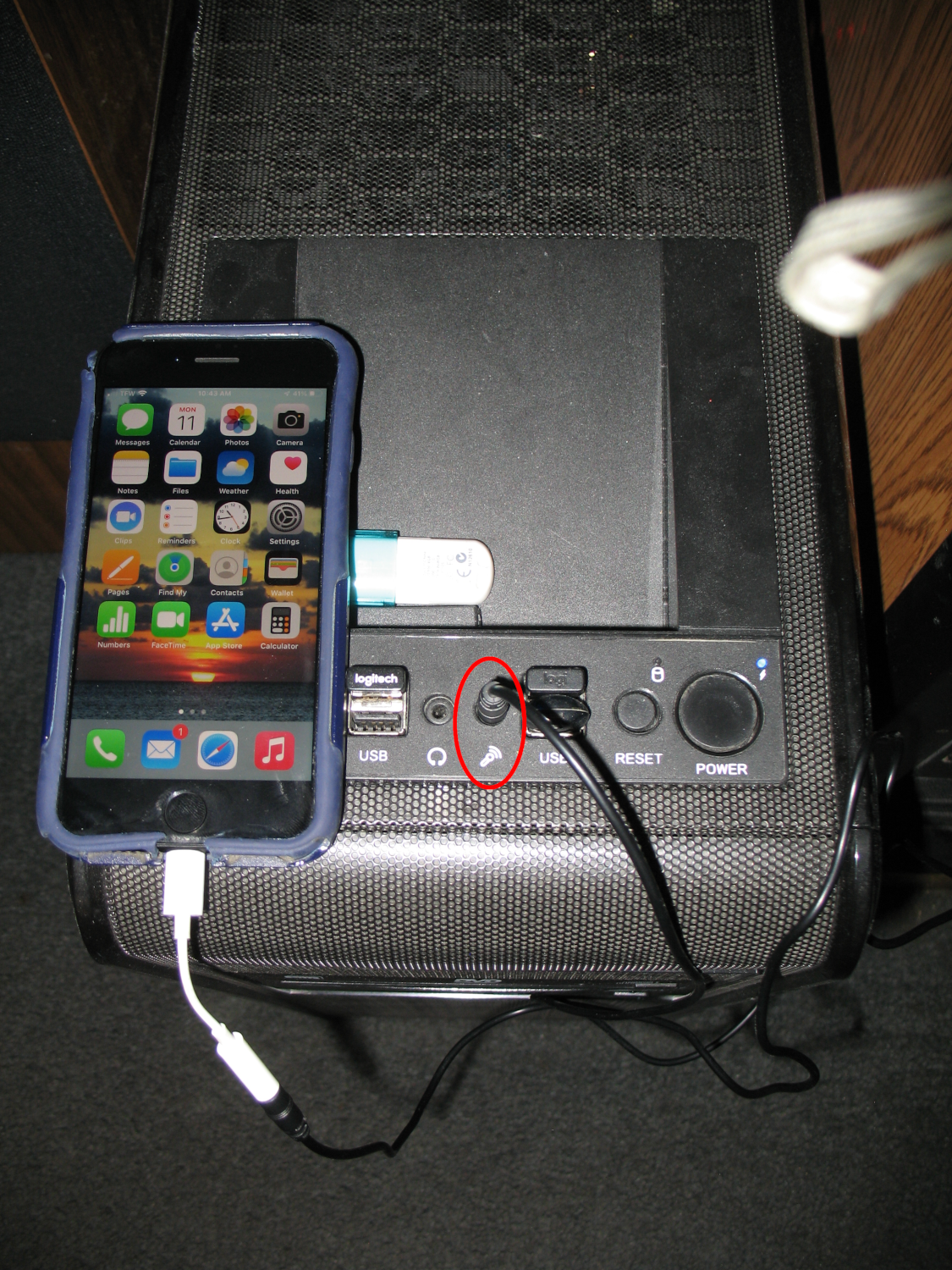

While I'm waiting on the adapter jacks to arrive in the mail, anyone want an official clean digital copy of the "This number has been disconnected" recording? I'm running Windows 10 and and used the free program Audacity to record the recording
And btw on a side note, using the white Apple lightning adapter to an unmodified 3.5 male jack to 3.5 male jack aux cord from the iPhone to the the microphone jack on the front of my PC, I am able to hear and record incoming live phone call audio. I know that's not what I was looking to do but I thought that was pretty cool. I can record phone conversations from my cell phone. I don't plan on doing that. But it's cool that I can! Apple doesn't like people doing things like that with their smart phone. I love figuring out how to do things on the un-jailbroken iPhone I bought and paid for that Apple doesn't want me to do. Haven't figured out yet how to record my end of what I'm saying in the conversation also, but give me time.

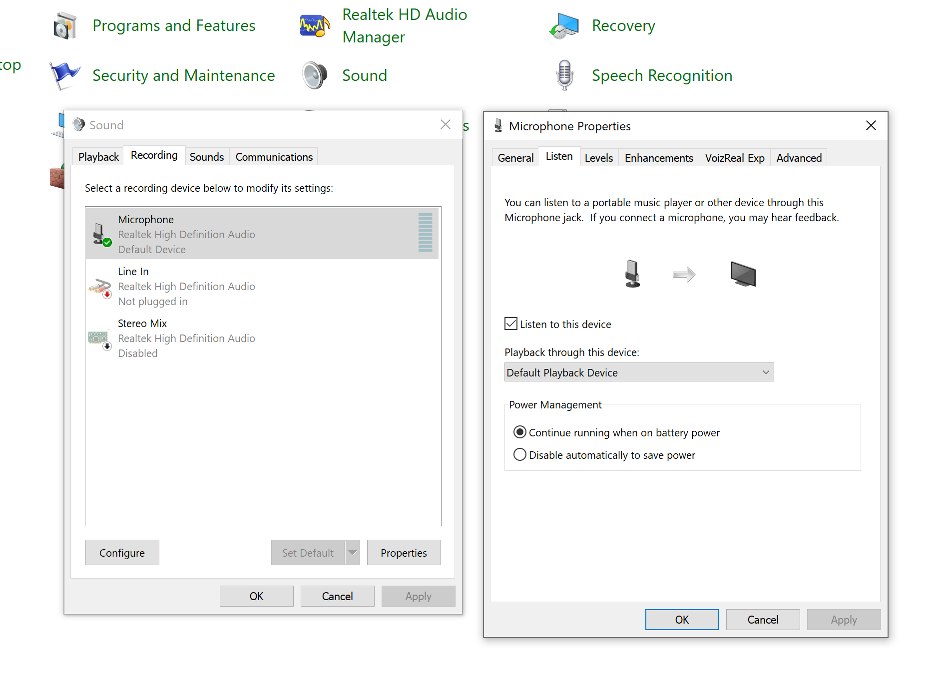

I had to go into the Windows Control Panel settings to get the audio from the iPhone to come through the PC:
Start/Control Panel/Sound/Recording/ (then right click once on the device to highlight the input device, ((which I had the iPhone set as "Mic", can also be set as "Line In")) then after highlighting the device go to Properties/Listen and then tick the box that says "Listen to this device". Done. iPhone live call audio output (..or any audio output from the iPhone..) to PC. Which then can be recorded by Audacity. Keep in mind also that the iPhone has to be plugged in to the PC mic jack and ready to go before those menu items will appear in Sound section menu of the control panel.
Disregard the grubby phone case

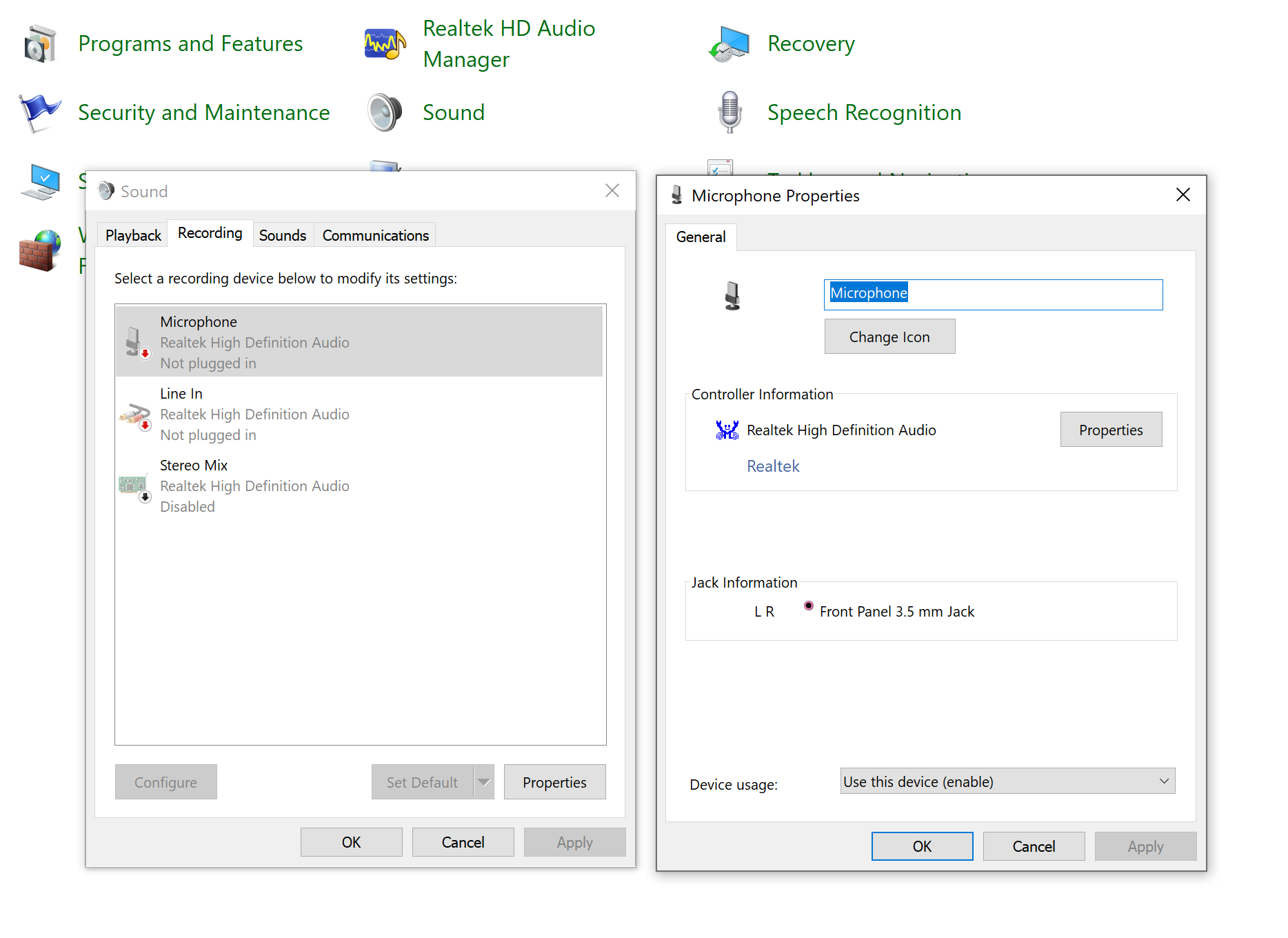

The Sound menu says Microphone "Not Plugged In" when connecting to the PC with a USB cable.

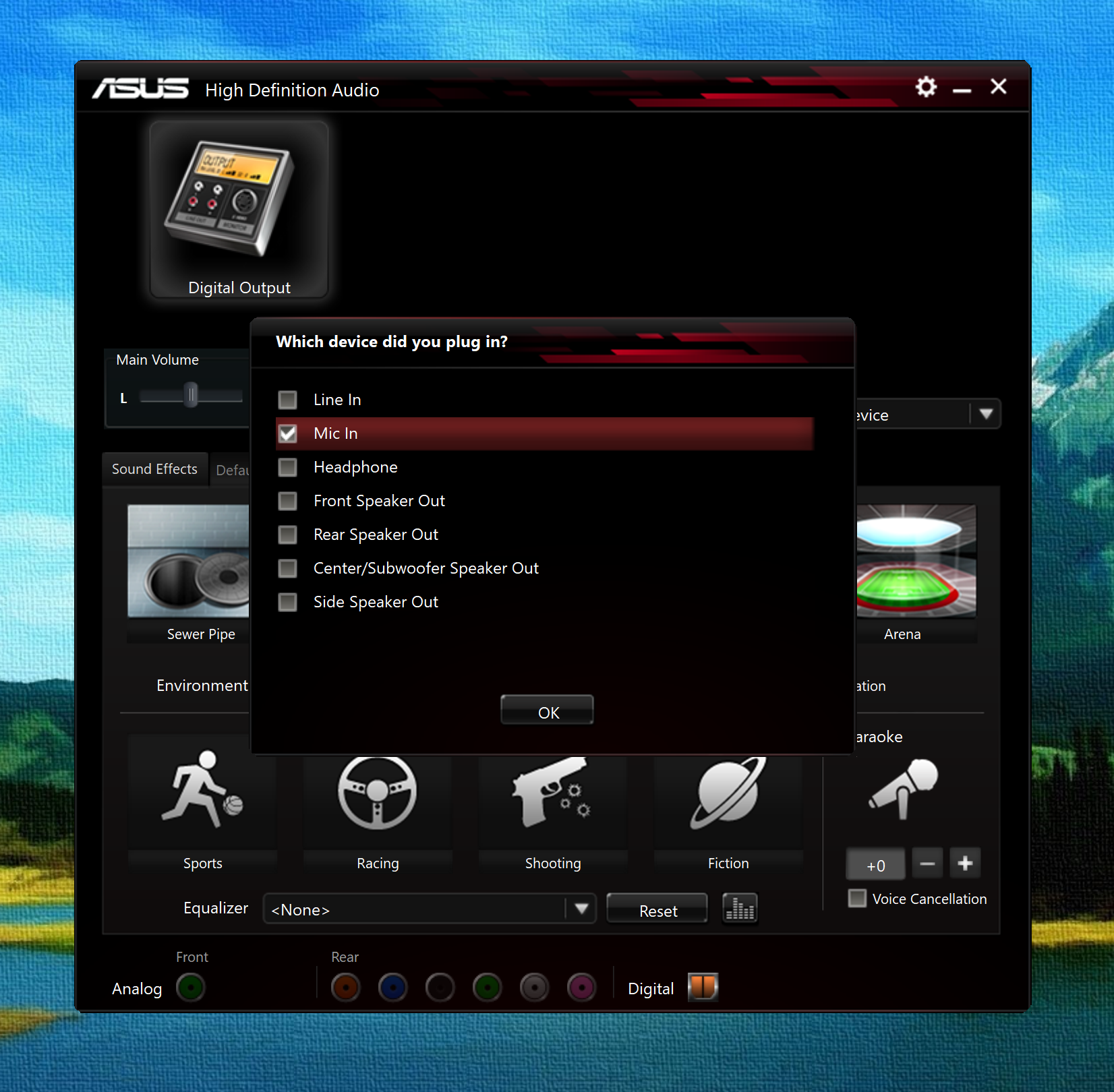

I also get this software pop from my Asus motherboard audio software when I plug in the iphone to the mic jack. The Asus software asks me what to classify the the connection as when I plug into the mic jack:

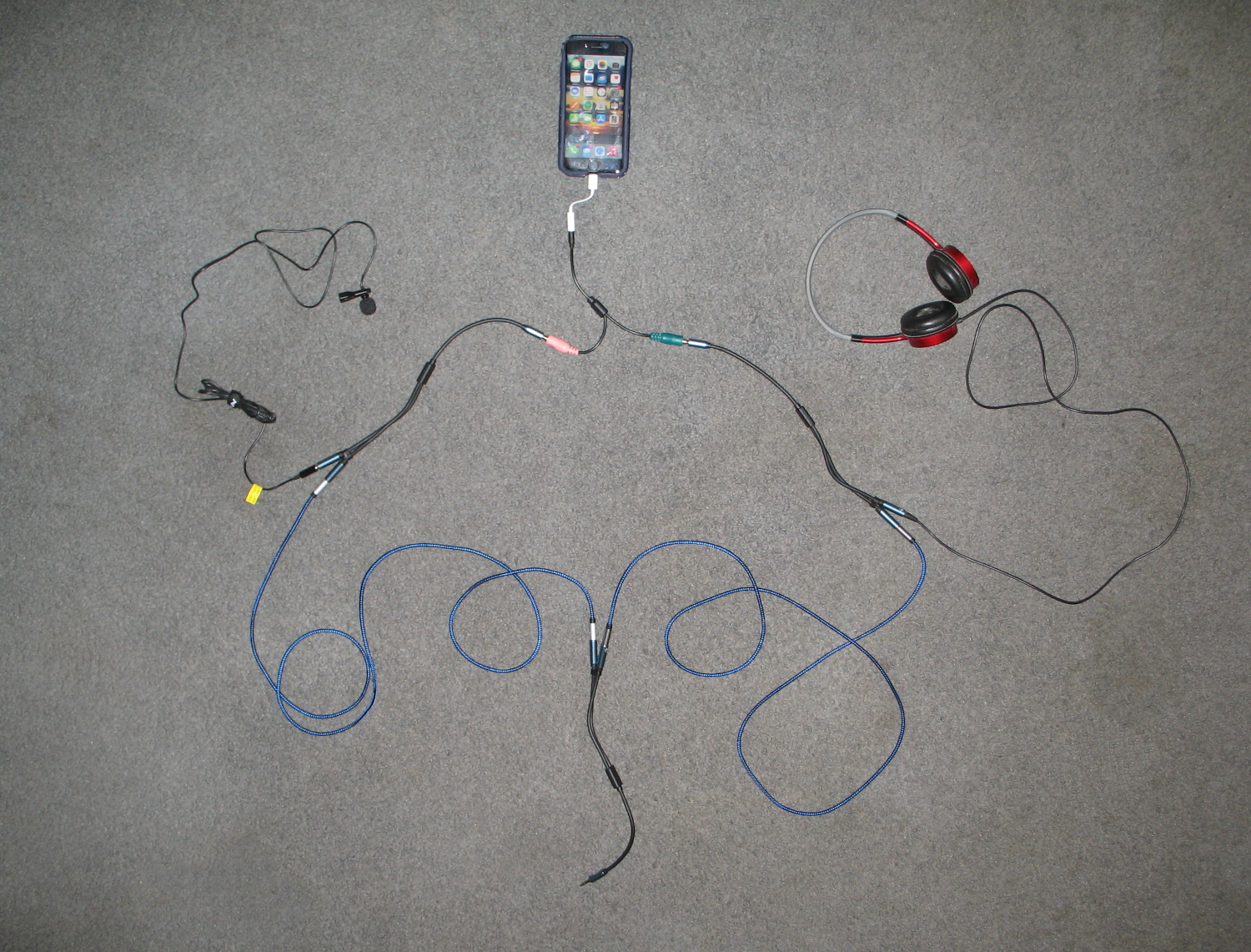

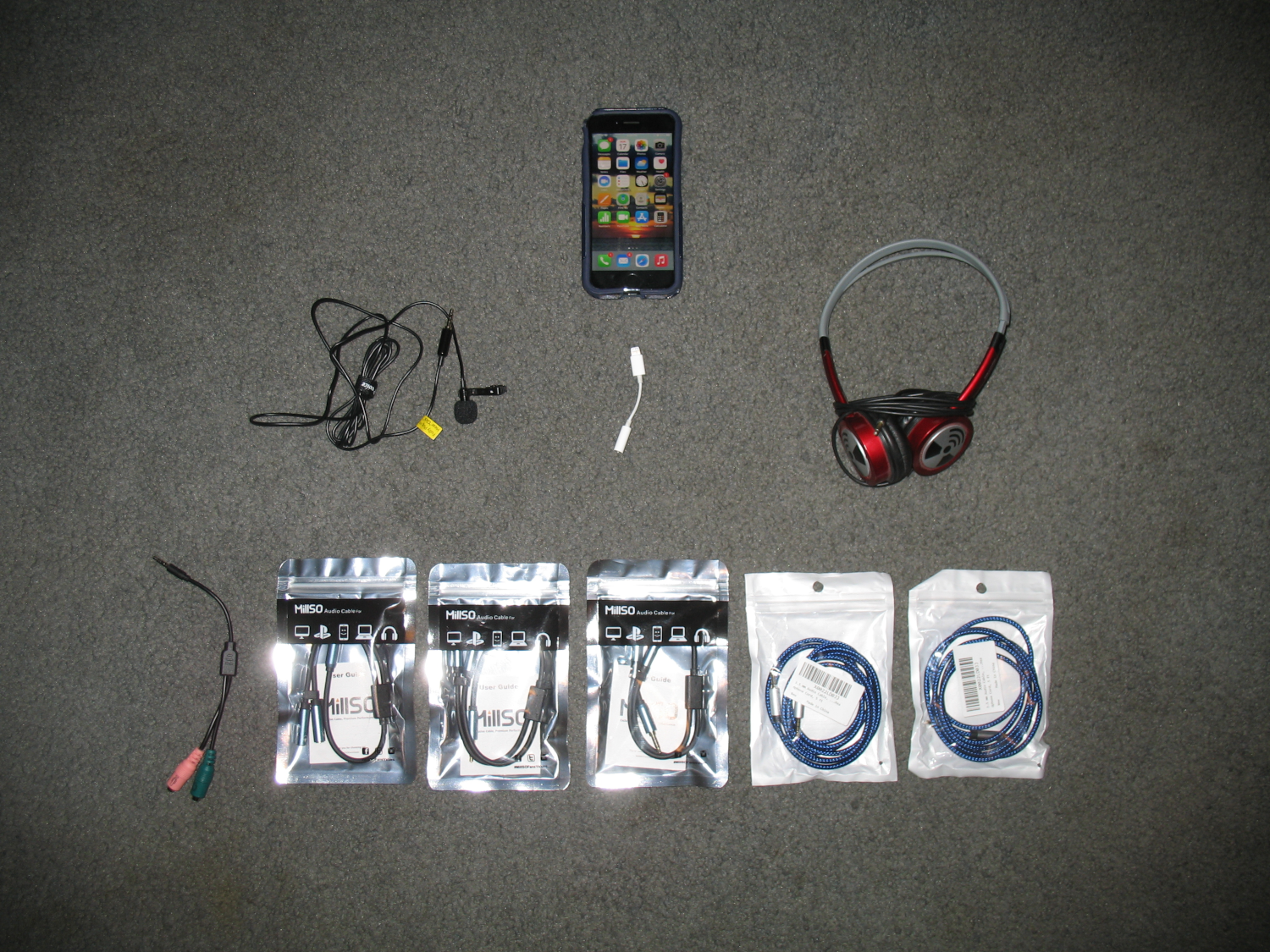

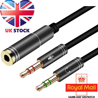

So I got a bunch of adapters and connectors in and this is what I've come up with to record phone calls from the iPhone without a 3rd party app that is a direct inline connection to the recording device/PC. The lapel mic that I bought works going in to the iPhone on phone calls but I cannot get this particular mic to work with Audacity going into the front panel mic jack on the PC. Not even directly plugging the mic into the PC jack without any adapters. The windows settings are right and I tried a bunch of different settings within Audacity. Does anyone know of a mic that definitely works with Audacity?
Here's the apparatus:
iphone>lightning to 3.5mm adapter>headset buddy splitter for mic and headphone>dual TRRS 4 pole splitter from headset buddy to headset and to PC mic jack (listen and record>dual TRRS 4 pole splitter from mic going into iPhone and into PC mic jack (talk and record).
With the apparatus Audacity records the incoming audio crystal clear from the headphone side so that's positive that the mic being hooked into the rig does not interfere with the incoming signal for recording. I really need to find a mic that works as an input to Audacity to see if this rig works in totality.

Normal PC audio sockets are either IN or OUT at any one time, and only work with three conductor plugs.
Nothing connects to the mic contact on the four pole plug.
You would need the inverse of the mobile phone headset adapter to convert a four pole phone headset with mic to two separate 3.5mm plugs, for it to work directly.
As far as the phone setup goes, if you can switch to the alternate source while recording voicemail and that takes it, it will work during any normal phone call.

Would you be so kind as to point one of those out to me? Because at the risk of sounding like a complete dunce I was under the impression that the mic output jack needed 4 pole jacks all around on the connection. Male and female. But not so with PC audio jacks you're saying.

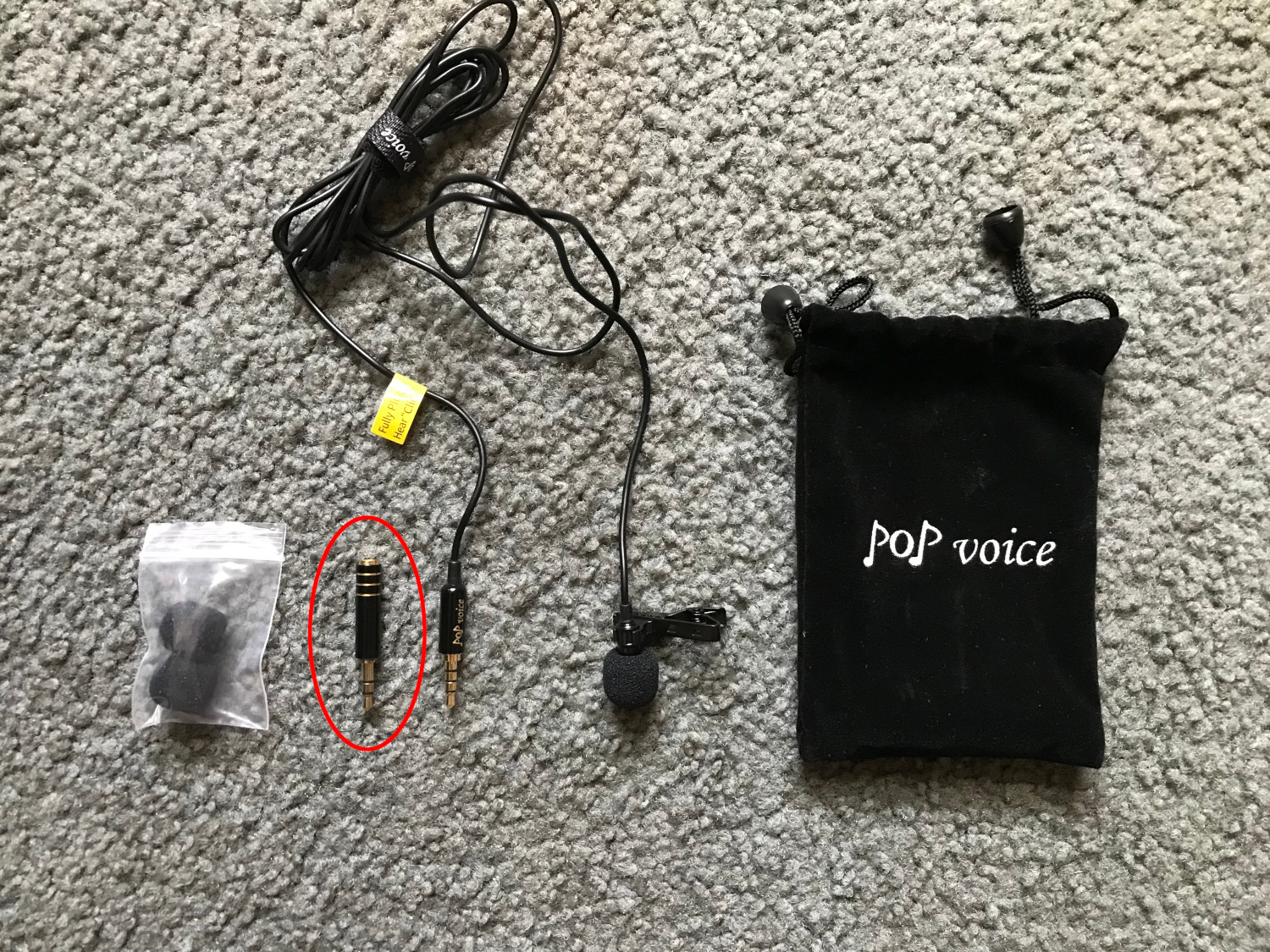

Update: Problem solved. I didn't realize it but the lapel mic that I bought came with a 4 pole to 3 pole adapter. I tried it and the mic works great with audacity now. Thanks for helping me figure that out!
All traditional PC audio sockets take standard three pole "stereo" plugs, with each socket being IN or OUT at any one time.
(I did mention this, back in post #5).
Most tablets & some of the newer laptops use a single four pole connection, like phones.
Example four pole to PC adapter:
I totally get it now. It was sounding more complicated than it really is. The 4 pole jack is a compact solution for the sake of condensement.

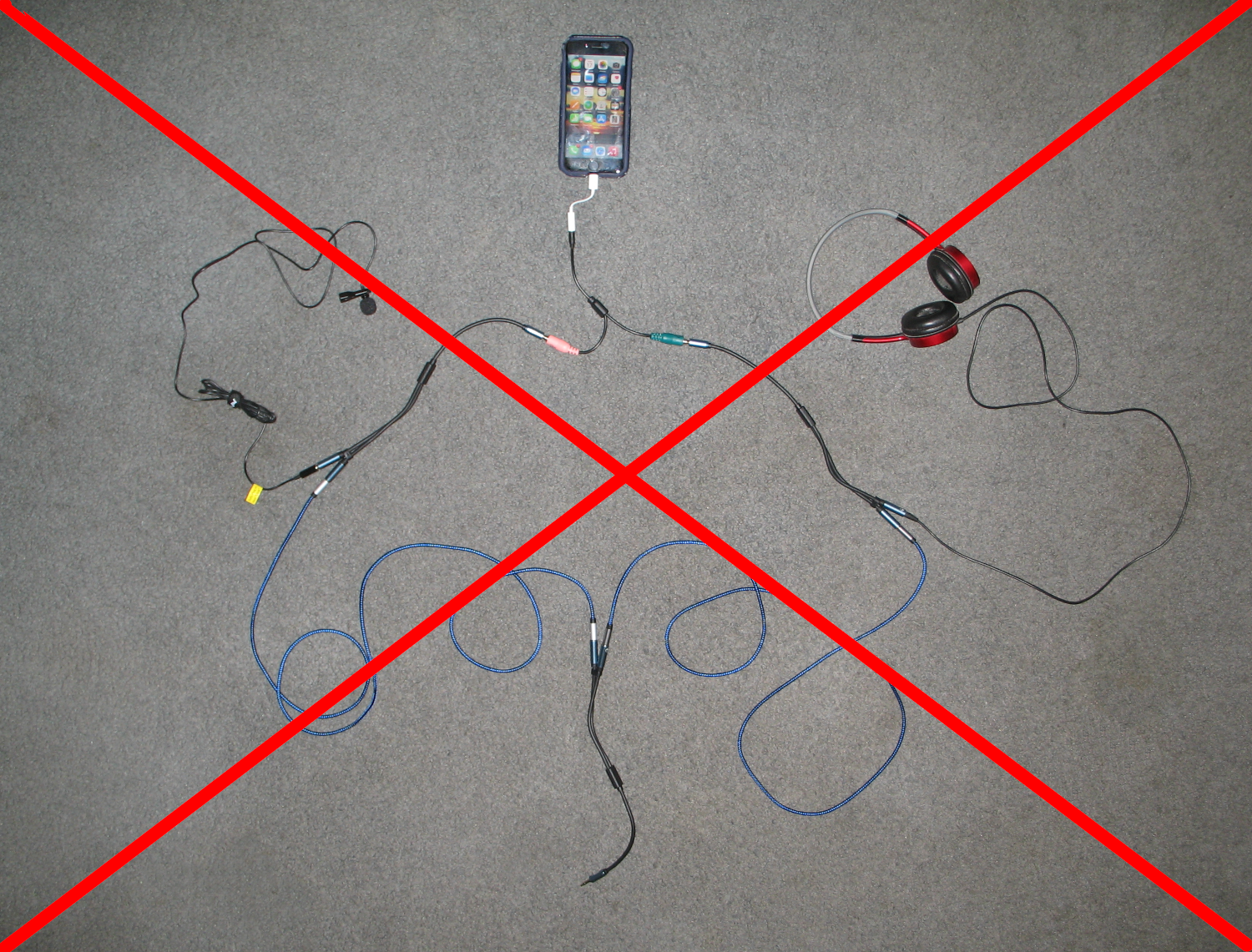

This did not work for recording live phone calls. I tried alternate connections in line with the same apparatus. Didn't work:

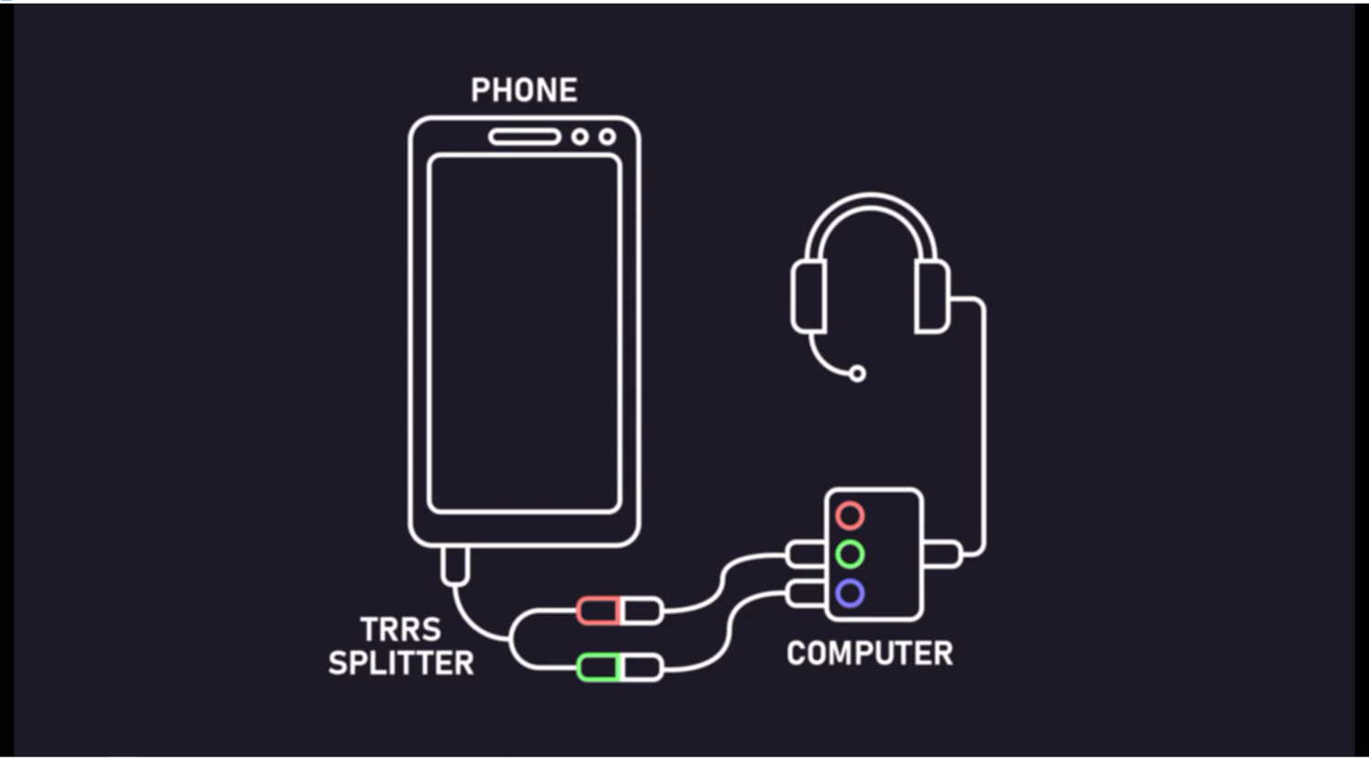

I found this on YouTube for recording live phone call from cell to PC. I can see that this is going to work. The cell phone is connected to the back of the PC via the TRRS splitter going to the line in and line out ports on the back of the PC. You then just connect your headspones+mic/headset to the front panel jacks on the front of the PC. Then all you need to do is check a couple software settings. This is totally going to work.
All that is needed for this setup is the TRRS splitter from the cell then two TRS male to male 3.5mm cords. $15 bucks at the most.
