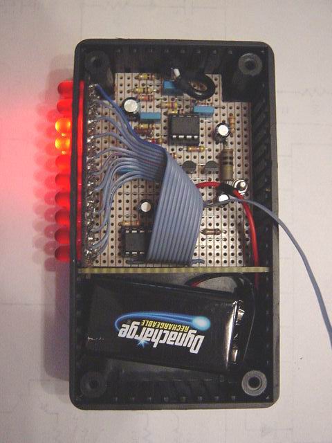

I have made many circuits with stripboard. It has parallel rows of copper strips that are cut to length with a drill bit. The copper strips form half the wiring of a pcb and resistors, capacitors and a few jumper wires form the other half of a pcb. The stripboard is perforated so all parts fit and can be soldered to it. One wire per hole.
If you want to change a part then it can easily be unsoldered and replaced with another part.
Here is an example:

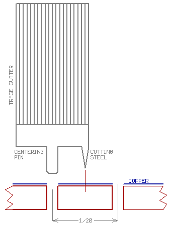

Here is the right tool to cut copper strips without messing up the board with holes. :)
Please replace "1/20" with "1/10"
Regards
Hans
Thanks Boncuk, Really a Nice tool. I was using normal pencil mender blades. Perhaps we have to get one fabricated locally and it is not off shelf, right?

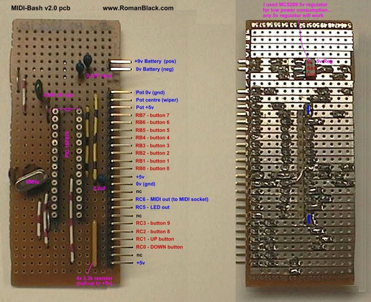

Veroboard is fantastic! In the hands of someone who already knows the parts pinouts and can just grab some transistors and solder them in, it's as fast as a breadboard AND permanent. It's reliable as any PCB (within the current specs). I've got test gear and PSUs that I made with vero 20-30 years ago and they have never missed a beat.
I can whip up a 555 device, or a 2 transistor temperature controller or a PIC doodad literally in a few minutes. Sure making PCBs is nice (and I do that too where its warranted) but I guarantee for small stuff I can vero it before you can finish even routing it on your PCB layout program... Then you have to print/iron/etch/drill etc.
I don't cut tracks that much on vero except between DIL IC pins of course. To cut tracks I use a 1/8" drillbit in a slow cordless electric screwdriver, it's perfect for cutting the copper neatly in about 2 seconds with no hassles apart from losing a hole. With a little experience you can keep all the jumper wires running one way and the tracks running the other, to keep track cutting to a minimum. Here's one for a 29pin PIC I prepared earlier (in a few minutes - complete with SMD regulator);

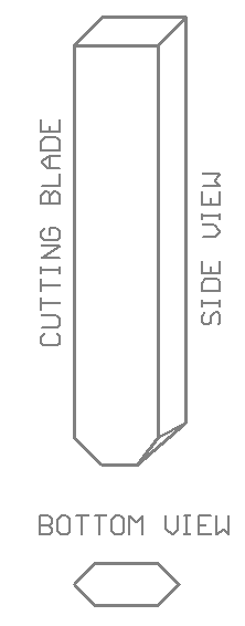

Hi mvs sarma,
in Germany it's an off shelf item. It is called "Leiterbahnunterbrecher".
I'll check for sources.
Boncuk
Here is one source:
Conrad Electronic - Europas führendes Versandhandelsunternehmen für Elektronik und Technik
Order number: 528008-62, price €5.10 (including sales tax)
Use the tool overlapping in cutting area to get a clean (half circle from both sides) cut.
It works fast and clean.
You might "manufacture" your own. Use a round piece of pine wood and drill two holes at 1/20" (1.27mm) distance, one for the centering pin and one for the blade. Insert the centering pin and the blade and fix with epoxy. Use stainless steel for the blade and sharpen it at both edges (before inserting). That way it will cut cw and ccw.
Boncuk
