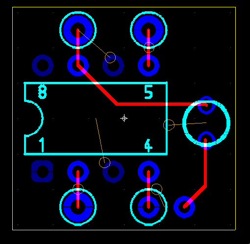

Is someone interested in designing a circuit board for this chip to have prototyped? Again, happy to pay a fair rate for your time.

using your MAX chip, for such a very very small circuit you could solder direct to the pins on the chip (or dip socket), or if you dont like that idea, a tiny bit of stripboard available from radioshack, maplin, digikey, mouser etc
OOPS just remembered MAX is SMT only, do you have the ability to solder to 'Industry's Smallest Pushbutton On/Off Controller'?
In your first post you say the switch is already in your box, is it connected to GND or +5v, as that will determine the layout of the circuit.

How many of these are you planning to make? one-off? a thousand?
For a single prototype for a one-off stripboard, and one of the circuits I posted would do. If its for multiple units then obviously the smaller the circuit (and more effective) the better, leaning towards the max chip.
SOT3/6 isn't tough to solder really if you are used to it, but yes you'll need a PCB for it, albeit a tiny one.

An alternative to the max chip would be this:
https://www.electro-tech-online.com/custompdfs/2008/10/doc4771.pdf
Available in DIP08, requires four external components (you can omit two of them if you're just driving an LED). Perfect for prototype board. Also in SOIC08 package if you need it smaller. Not quite as perfect as the MAX solution.
