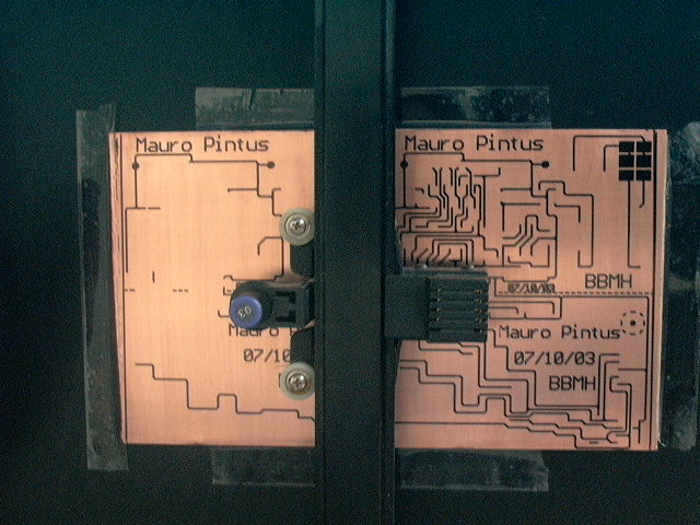

does anyone know any DIY or homebuilt PCB plotter?
i think it is hard for me to go on with letrast and pencil...!
thanks for any help

i am talking about a thing like this pic.

anyway that plotter(at the pic) use from a program for drawing the PCB on the PC.
your idea is a good idea but the pic i have showed does not need for etched....
i think if some one could make a thing like the pic he shoud be able to do some of changes and mount a motor (drill)on it and makes the holes too
what do you think?
Are you talking about a milling machine which mechanically removes unwanted copper? If so, here is a homemade one. Google on "homemade pc board milling" and "homemade pc board router".
