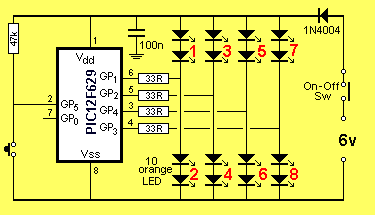

I have a simple circuit using a PIC chip that does what you require:
Is this for only 8 leds though? I would need two rows of 8 leds, for a total of 16 leds. Would I have to program anything on the pic, or does your drawing include all the codes necessary to run the 12 patterns described.
Thanks,Patrick
There are 16 LEDs on the circuit diagram.
Oh ok I see it now. Are all the codes on the diagram for the 12 patterns?

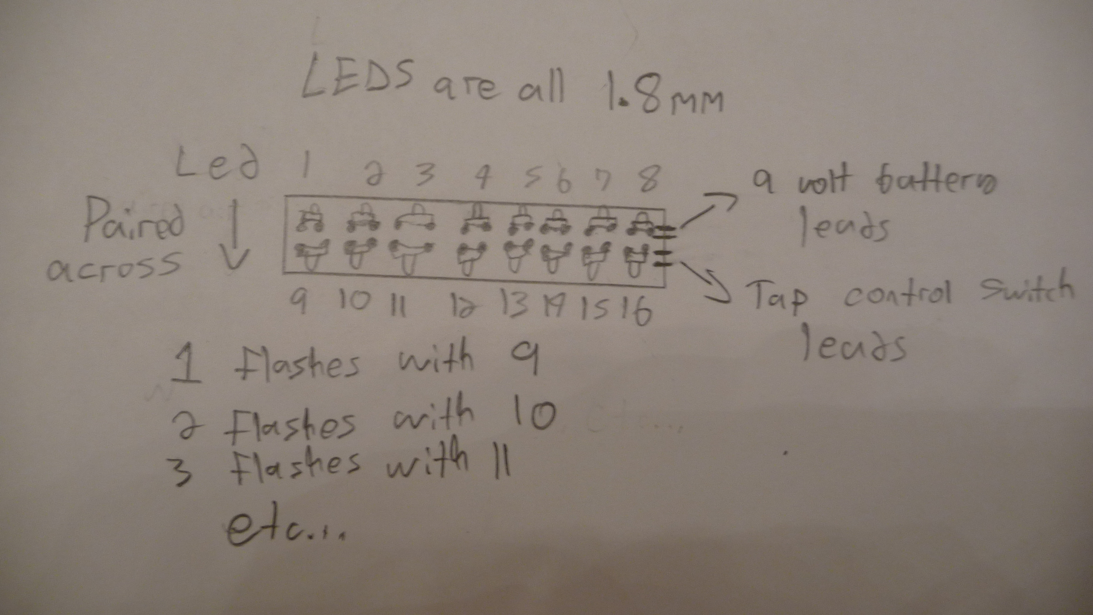

Would this also come out to be 2 and 1/4 inches long by 0.5 inches wide?
Here is a quick drawing I put together.

So it's only 8 LEDs since the front & back are paired, that does make it simpler. A simple 4x2 mux would allow that and be fairly simple to program and could still use a tiny 8 pin PIC (4+1 for the mux, 1 for a pushbutton) with the current state pattern stored in EEPROM.

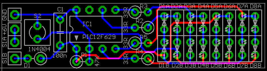

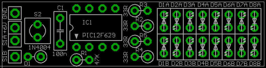

according to colin's suggested circuit here is a PCB layout.
Dimensions are: 2.0250X0.5inches
Except for the ON/OFF switch everything is on board.
PM me for the Eagle files.

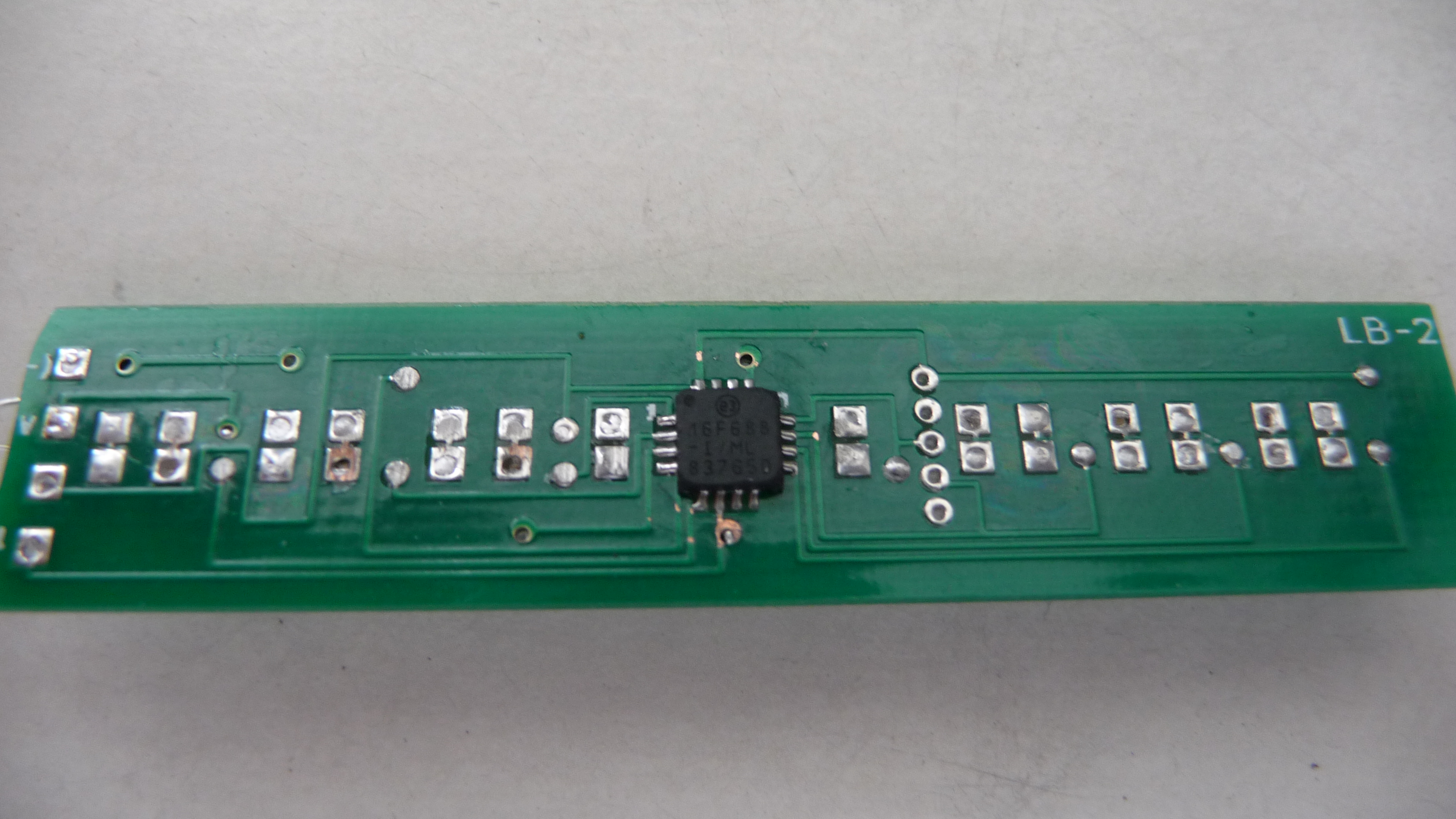

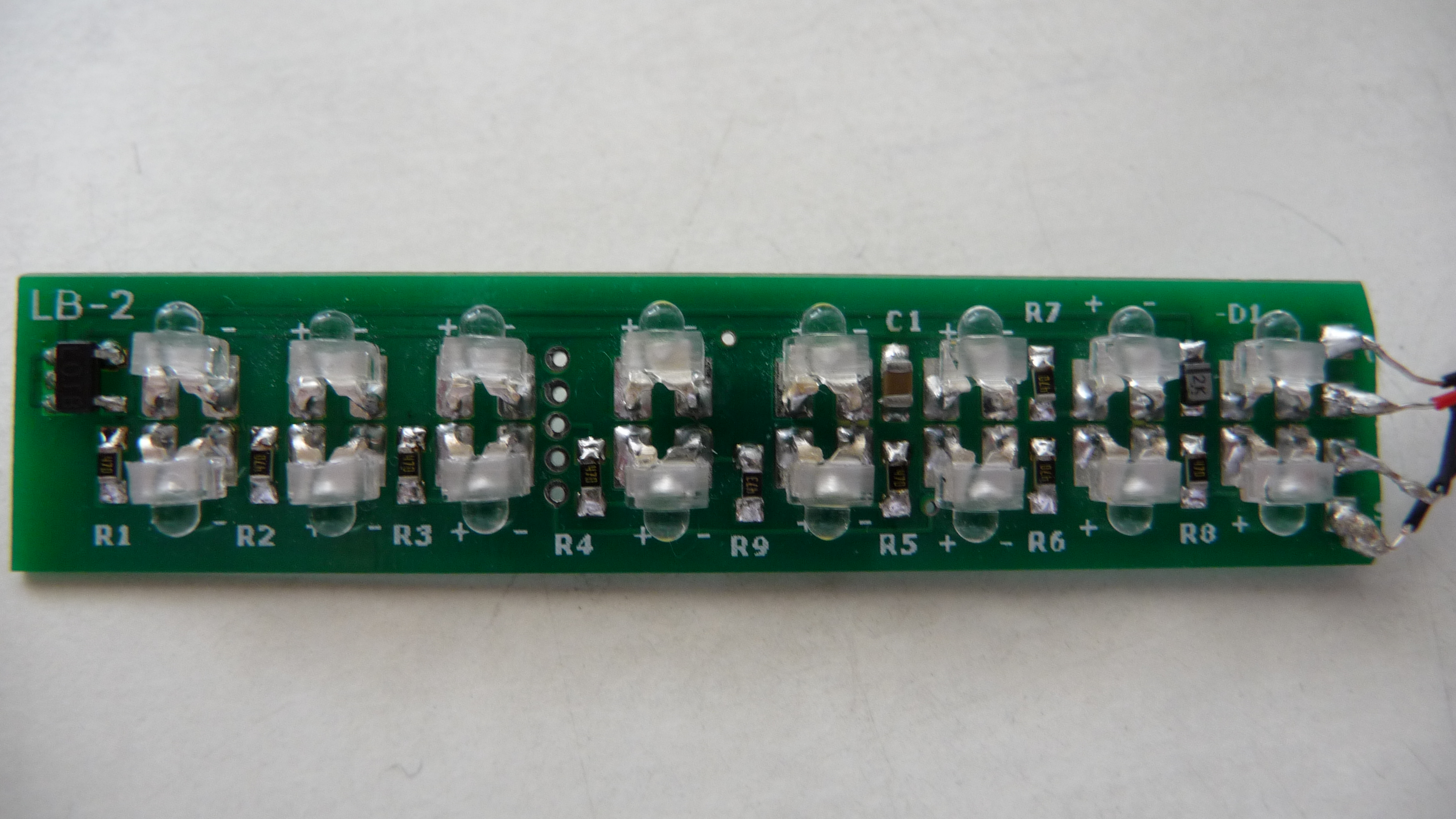

I finnaly found it!!!
I have been looking for this for weeks after I moved.
Here are pictures of what I am trying to get a layout/schematic for.
What Colin came up with was almost like it except for the leds wern't layed out across the whole board and the pic is on the bottom off the pcb.
Can someone help me get a layout/schematic for this?
Boncuk?
