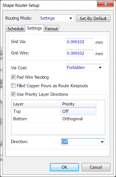

Superdat - If you ask DIPtrace very nicely (assure them it's for personal use only - it is for me) they'll upgrade you to 500 pins. That does not include vias so have any number of them. Personally I hate vias and try to do without, so have set the prog not to use them. My only complaint with DIPtrace is that I can't seem to force a s/s board... maybe there's something I'm missing. Anyhow, I can make it s/s easily enough. Have now added lots of components with their respective patterns, so am really pleased with it. Like I said before, I'm used to AutoCAD so I get on well with it.

Aardvark, when you say you can't force a s/s board, are you refering to the PCB layout? The default is always d/s but unless you select the other side it will remain on one side i.e. s/s.
The exception is SMD components which by default go on the copper side as they should.

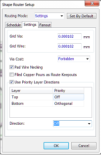

I've just figured out how to force s/s.
Route>Autorouter Setup>Settings>layer section lower down
Choose either Top or Bottom and set Priority to "Off"
