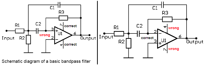

The circuit designer got a couple of things wrong in his discussion of the circuit:
Pins 4 and 7 should also be connected to a power supply.

The main schematic uses quad opamps and their pins are correct.
The discussion of the circuits had the pins on the opamps wrong.

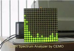

Here is another audio spectrum analyser project. It uses a microcontroller to make the hardware very simple:
https://www.electronics-lab.com/blog/?cat=8
It looks great, but I have no idea about microcontrollers nor this screen :(
