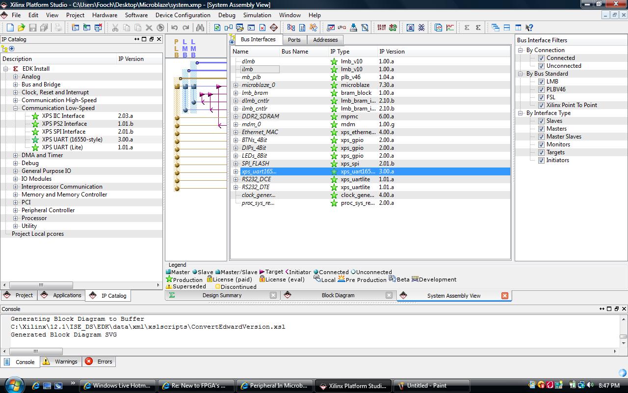

So I have been able to get microblaze setup in platform studio. I also took Xilinx's xps_uart16550 and put it in the peripherals list. I then looked at the data sheet for it and think it should work.
I'm a little stuck now. Where do I go from here? Generally what are the next steps so I can program the FPGA and start sending it characters so it can shoot them back to my computer? I"m not looking for you to write me a tutorial but just need some direction. Below is a pic of where I"m at...sadly not very far but it's a start. If I need to struggle some more let me know....I've just been reading tutorials and was on youtube which is just confusing me.
