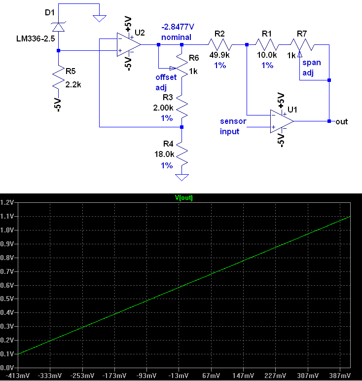

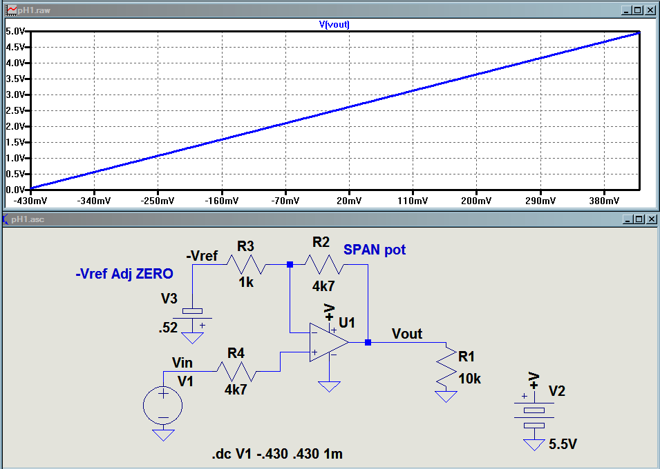

I have MCP607. I even tried to built it my adding the voltages at the initial stages. Here is the new schematic attached. I gives 600mv at 0mv input. But at the extreme it fails like +413 should give 100mv and -413 mv should give 1100.
Their is the differene of 50mv on both side.
Looked at your drawing, where did you connect the probe.?
Also would a minimum pH of 2 thru to 14 be acceptable.?
Look at this option, just shows the basic circuit.:)
The -Vref should be derived from a voltage reference and be adjustable.
Note: for the MCP607 the recommended -Vsig is -0.3V [not -0.413V], so there is a minimum pH signal limit.
If you used a CA3140 opa this would allow a -0.5V input.

My understanding is that the input span is -413mV to +413mV, and the output span needs to be 100mV to 1100mV. Below is a circuit that should do this. Op amps need to have CMOS inputs.
hi Ron,
Are you saying that you want to shift the -413mV thru +413mV input range to, 0V thru +826mV or 0V thru +5V.???
yes i that to do that. Need help for the schematic
