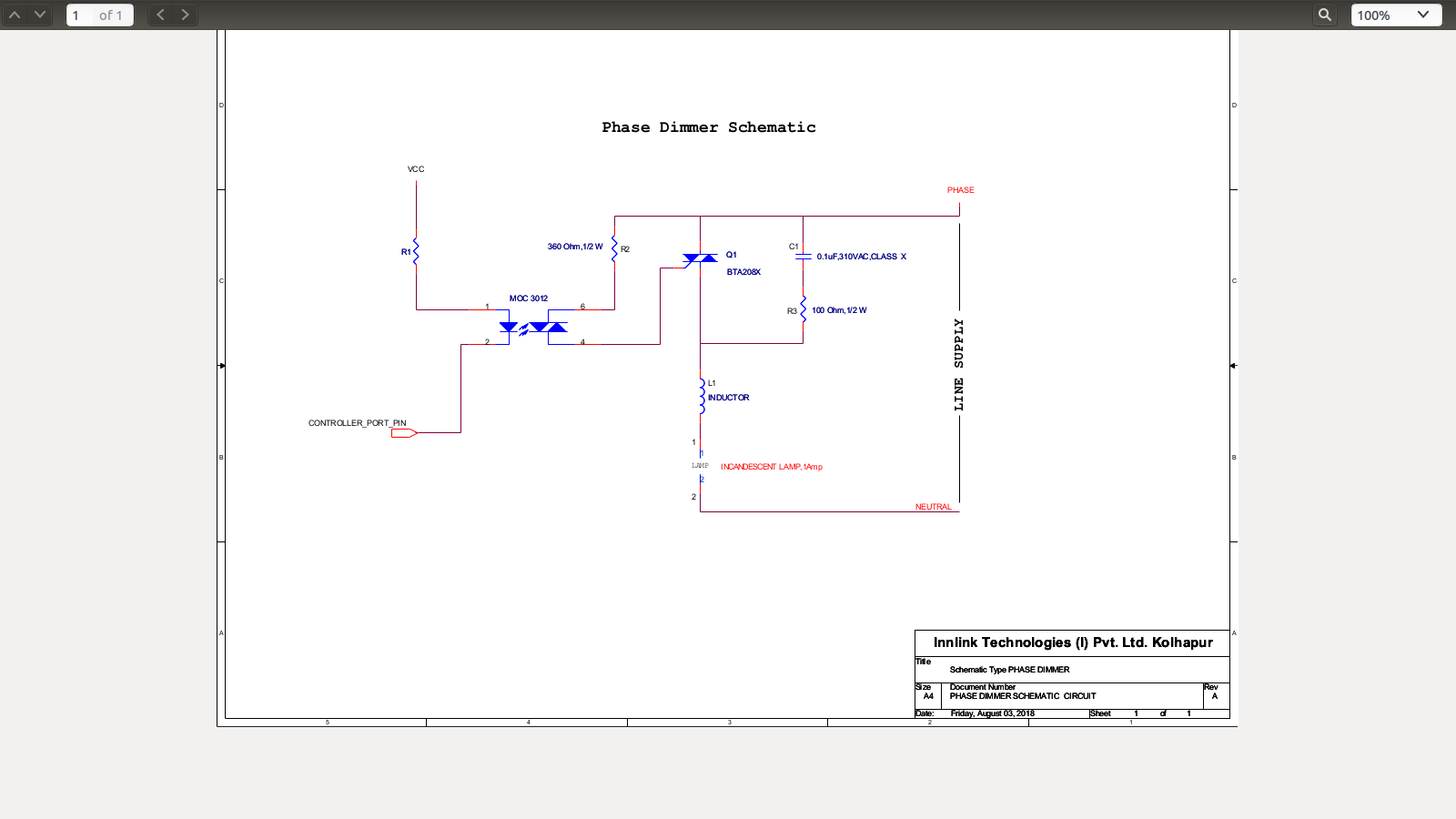

I am engineering student making phase dimmer control using triac
The schematic is as attached
What I have observed that many times attached circuit stop working due to failure of triac
I am not sure is it because of di/dt or dv/dt failure. In order to avoid this I have used triac of much higher rating (10A) even though current needed can be as low as 1A.
However the problem continues.
I have observed that the failure is for transformer powered halogen lamp (inductive load?) and for ceiling fans.
It works satisfactorily for incandescent lamps.
Also I am sharing one more observation that if I connect glass tube fuse link in series with the load then the fuse blows.
From the various information available I realized that I need to use choke / inductor to overcome this problem. Is that right?

  • Phase_Dimmer_Schematic.pdf
A light dimmer like that, which switches power on part way through each half cycle, can only work well with a direct filament lamp load.
To dim any other type of lamp, a different circuit has to be used where the power is on from the zero crossing of the AC supply and turned off at some point through each half cycle.
eg. A basic triac dimmer gives an output waveform like this:
To control the type of thing you are trying to drive, the waveform must be like this:
That presumably needs something like a GTO thyristor or IGBT to enable switching off under load in each half cycle?
Edit - this article gives an example of a dimmer circuit of that type, with "trailing edge" switching:
