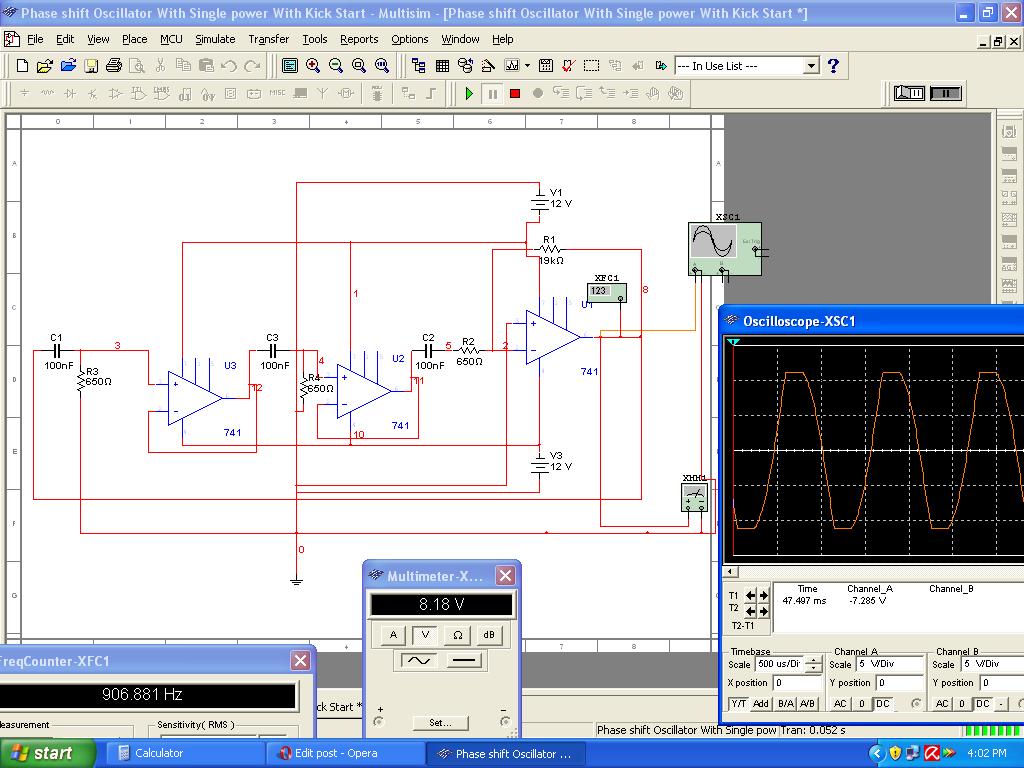

hey! i've completed my oscillator with three opamp but the output is not going beyond 8v. if i'm decreasing the gain, the sine wave is coming fine (without clipping) but i want that if i'm applying 12Vdc I should have 12vAc.i'm not understanding why this is happening.?
without thes non-inverting amplifiers the Rf is 19k and the sine wave is coming fine.but as i'm increasing the non-inverting amplifiers the sine wave is getting clipped but the output voltage is not going ahead 8v.
an OpAmp is able to give move than 8v. am i right.?
any guass? help me Thanks
here is the circuit

Looking at your oscilloscope trace, you're outputting abou 11V peak, which is about right for the 741. You won't get the full 12 swing, as this op-amp is not a rail to rail device.
I think the meter in the sim program reads RMS not peak.
The output is shown as 23V peak-to-peak which is about 8.2V RMS.
Actually a 741 opamp has a max output of only 21V p-p or less, not 23V p-p when it has a positive and negative 12V supply.

The max output high of a 741 opamp is the positive supply voltage minus about 1V.
The max output low of a 741 opamp is the negative supply voltage minus about 1V.
Then if the supplies are 12V each the peak voltage is about 11V.
Your sim's meter reads RMS, not peak. RMS is 0.707 times the peak. So the output is 11V x 0.707= 7.8V RMS.
7.8V RMS is about 65% of the 12V supplies.
Since you want 10V RMS or 11V RMS then it is a peak of 14.14V or 15.5V. The output of a 741 opamp needs 1V more so your supply must be plus and minus 15.14V or 16.5V.

The maximum theoretical RMS output voltage for a sinewave is 70.7% of the input voltage, with most real op-amps the output voltage will be much lower.

Hey! Thanks every one I've got it That i was talking the RMS as Peak. Now every thing is clear.

Yes, you've got it, the RMS voltage is 1/√2 of the peak so of course you can't get more than that which is 70.7%.
